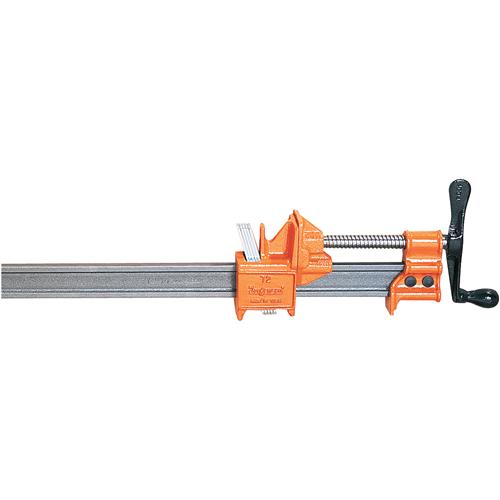

After breaking the 3/4 inch pipe on 3 of my pipe clamps, I started looking for better heavy duty clamps. I remember using Jorgensen I Beam bar clamps in High School shops and found they are still available thru several sources including www.clamps.com. They are not that much more expensive than pipe clamps by the time you buy the clamp head and the pipe and are rated for 7000 lbs clamping pressure.
- g3543.jpg (13.7 KiB) Viewed 1321 times
