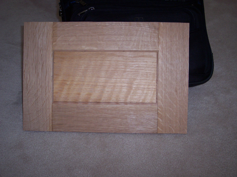

Finally getting around to making a new front-panel for the chest. This part was totally missing from the original.
I used the SS Bandsaw quite happily for resawing 3/4"-thick oak into thin planks. When I have a nice, reasonably fresh blade, I can cut a very true 6"-wide resaw just by running the timber right down the fence, no aligning for 'drift'.
I used QS White Oak for the frames. For the middle panel, I deviated to Red Oak and used a nice plank that I found a few years ago at ACE hardware of all places :D .
On the top & bottom frame-pieces I added a 1/8" thick groove with the tablesaw mode. For the side pieces I used a 1/8" bit in the Router Chuck and ran the PowerPro fairly fast for stopped cuts. The grooves were for holding the center panel; I don't have a true tongue&groove joinery. My frame pieces are doweled together. I just basically like doing dowel joinery with the Shopsmith.
Haven't had time to clean it up and stain it yet...
[ATTACH]17735[/ATTACH]
New Front Panel.jpg (107.8 KiB) Viewed 3616 times
Chris

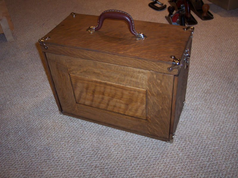

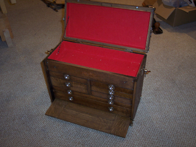

The front panel came out pretty decent. I had to trim every which way with a block-plane, then install the retainer-pins (on the lid) and sockets (on the front-panel's top edge).
It's pretty much done, just some color-evening and odds and ends to tidy up. A long project over many sessions, but very fun!
[ATTACH]17793[/ATTACH]
[ATTACH]17794[/ATTACH]
Buttoned Up Chest.jpg (113.46 KiB) Viewed 3586 times
Open for Business.jpg (112.84 KiB) Viewed 3585 times
Chris

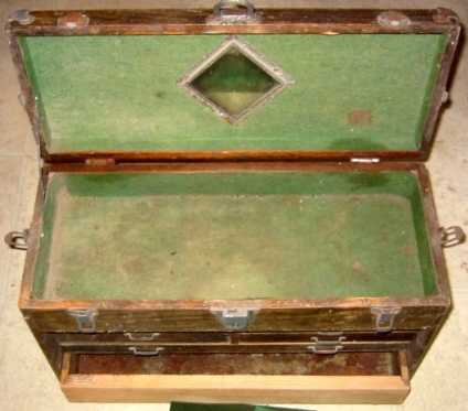

Here's Chest #2 in raw form. There's a few differences as I get into what I got...
[ATTACH]18154[/ATTACH]
#1 was Quartersawn white oak. #2 is more conventional cuts of red oak.
#1 had wood drawer-bottoms, and several cracks in the all-wood drawers. #2 has (rusty) tin-bottom drawers, plus missing drawer parts altogether.
#1 was solid wood everywhere. #2 has a plywood top and back, plus really ugly almost black stain which I'm planing off.
Chris
