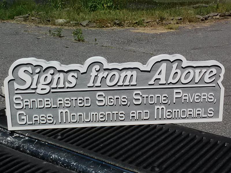

Ed, I believe what you're looking for is an HDU signboard. It's available from most sign supply warehouses, but it's expensive. It can be routed, carved, sandblasted or cut with a waterjet. It comes in 1, 1-1/2 and 2" thicknesses, and precut to sign shapes. I'm familiar with it from my Sandcarving hobby. You can place a mask on it, and sandblast into it and get real nice dimensional signs. As far as cost, a 4x8' sheet of 1" thick HDU is $206.
Below is a sign a friend did in 2" thick HDU, ready for final paint.
[ATTACH]18114[/ATTACH]

I have seen signs like this but had no idea what the material was. I'm going to look into it a bit and see if they have thinner versions and cheaper prices.tom_k/mo wrote:Ed, I believe what you're looking for is an HDU signboard. It's available from most sign supply warehouses, but it's expensive. It can be routed, carved, sandblasted or cut with a waterjet. It comes in 1, 1-1/2 and 2" thicknesses, and precut to sign shapes. I'm familiar with it from my Sandcarving hobby. You can place a mask on it, and sandblast into it and get real nice dimensional signs. As far as cost, a 4x8' sheet of 1" thick HDU is $206.
