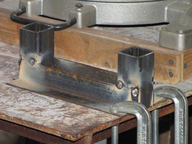

I finally got around to building a couple of my own versions of the SPT Mounting Base. I repurposed some 1 1/4 x 1 1/4 x 1/8 angle iron I reclaimed from some storage shelves that I build several years ago, that I no longer have room for, and found some square steel tubing that was the perfect ID to slip over the mounting tubes. So I set up the DW chop saw and my Miller squirt (wire) welder and did some chopping and hot-gluing today. A little clean-up, some mounting holes drilled, and some spray paint, and I should be good to go.
The second one will be used to safely store my second SS bandsaw.
Base:
[ATTACH]18157[/ATTACH]

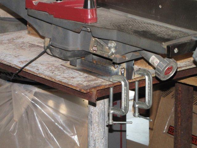

Test fit of the jointer:
[ATTACH]18158[/ATTACH]
The ultimate goal for the jointer stand is to further repurpose some metal and build a power stand for the jointer.

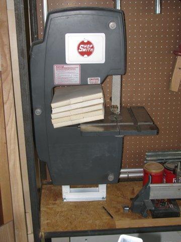

Here is what I was using to store the BS....It was not really tall enough, and, I was not comfortable with the long term durability.....especially for the side torque/twist of the jointer.

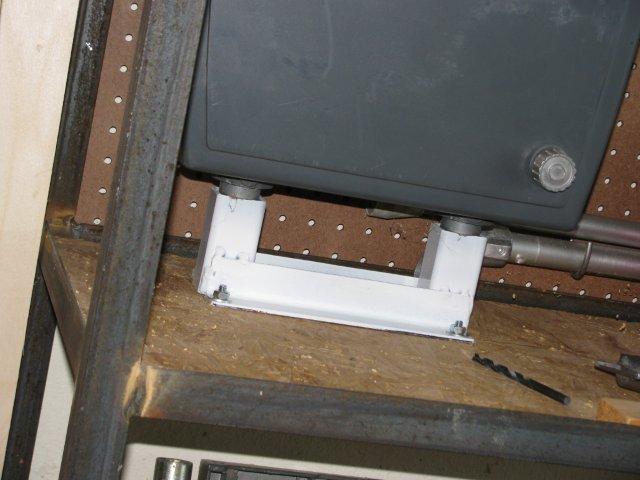

A couple of shots of the BS stand.
[ATTACH]18196[/ATTACH]
[ATTACH]18197[/ATTACH]

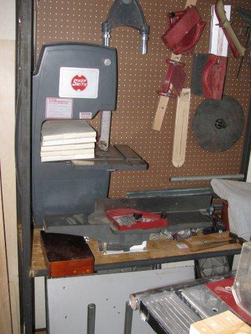

And one of the jointer stand.
[ATTACH]18198[/ATTACH]
Much more sturdy and stable.

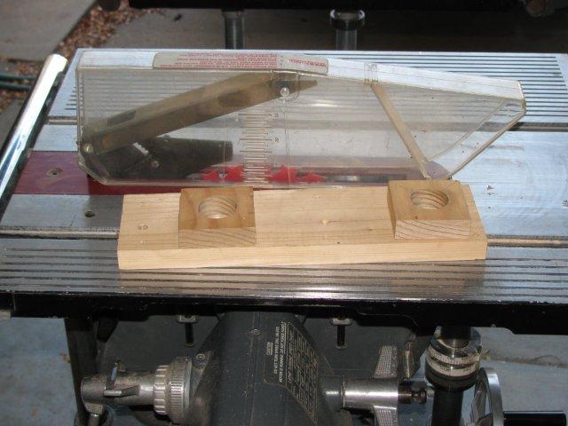

Space seems to always dictate what we can do. Some people have those Shopsmith storage bases. Years ago, I took a 2 x 8 or a 2 x 10 and simply drilled holes to match the SPT tubes and that lasted. I could of used the SPT 505655 aluminum mounting base- but they are expensive! So I just used a few supports and hung the 2 x on the wall and that's where the SPTs lived when they weren't being used. I had to get them off the floor and used the extra space in the board for the lathe chisels and things that wee eating the peg boarbfggvvbvbd I mounted above & behind the SPT storage board.
