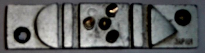

db5
Posts: 1192
Location: Oklahoma City
Here's your Jig
Post by db5 »
I've had this for 40 years and you can build one. Use hardwood only as softwood will not hold the pressure particularly if you heat the rod. I recommend overlaying it with aluminum or steel but that isn't necessary if you do this only occasionally. Note the attachment. You may only want to produce the center section with the posts inserted into holes. Make sure that both the posts and the spaces between the posts that insert into the board are just slightly larger than what you want to bend. You can probably have them 1/2 inch if you are bending 3/8 rod (perhaps even more). How you position the posts determines the radius of the bend.
You will probably need to heat the rod before bending it. It doesn't need to be red but needs to be so hot that you probably can smell it.
This is one of the best jigs I ever ran across.
wrmnfzy
Posts: 758
Location: Destrehan, LA
jig
Post by wrmnfzy »
I'm ordering one very similar to it for next time. Might try to make one similar out of wood to see if I can use it. Right now the hurricane may be pushing plans back. Thx.:D
