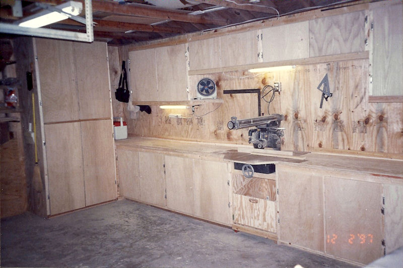

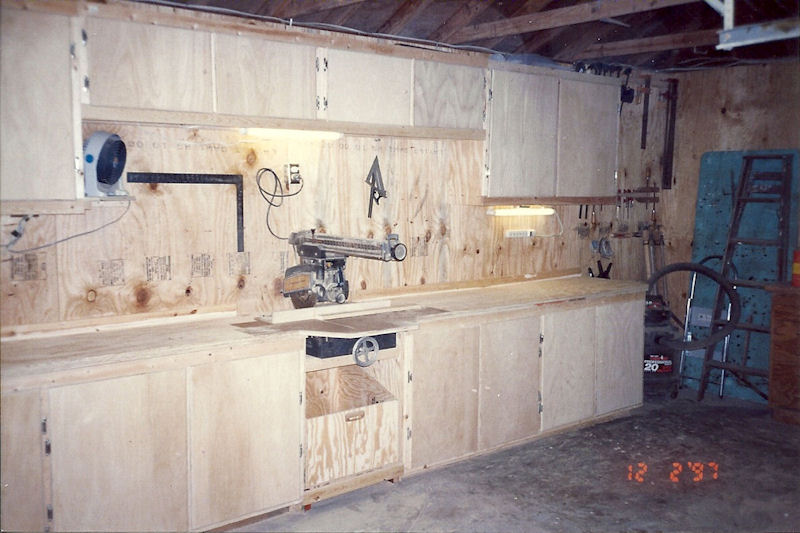

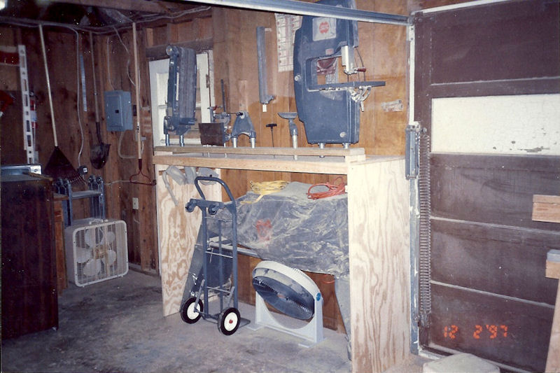

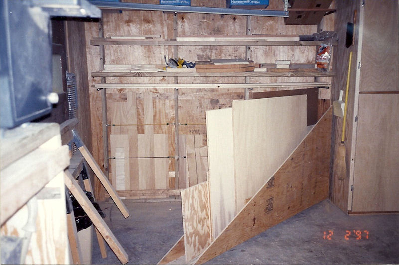

Here's some of my former shop
Here are some of my former shop.
- SS Asher St. Work Shop.jpg (109.95 KiB) Viewed 817 times
- SS Asher St. Work Shop 2.jpg (97.14 KiB) Viewed 803 times
- SS Asher St. Work Shop 3.jpg (95.91 KiB) Viewed 803 times
- SS Asher St. Work Shop 4.jpg (103.27 KiB) Viewed 802 times
