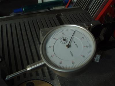

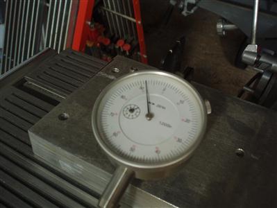

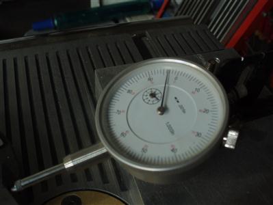

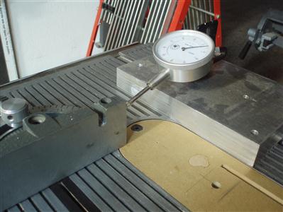

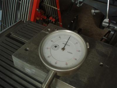

I have two Shopsmith miter gauges. The slop on the two of them is not the same. It could probably be adjusted to make them the same but WHY?
One of them exhibits .005" of slop and the other is now .004". The later was .007" before I adjusted the tapered screw.
Pictures to follow in two separate posts (more than 5 images to show).
[ATTACH]18737[/ATTACH]
Initial Setup
[ATTACH]18738[/ATTACH]
First Miter Gauge
[ATTACH]18739[/ATTACH]
Still First Miter Gauge
[ATTACH]18740[/ATTACH]
Other Miter Gauge
[ATTACH]18741[/ATTACH]
Other Miter Gauge

- Initial Setup.JPG (28.28 KiB) Viewed 1451 times
- Miter Bar Slop 002 (Custom).JPG (22.54 KiB) Viewed 1451 times
- Miter Bar Slop 003 (Custom).JPG (22.26 KiB) Viewed 1454 times
- Miter Bar Slop 008 (Custom).JPG (23.58 KiB) Viewed 1454 times
- Miter Bar Slop 009 (Custom).JPG (23.96 KiB) Viewed 1448 times

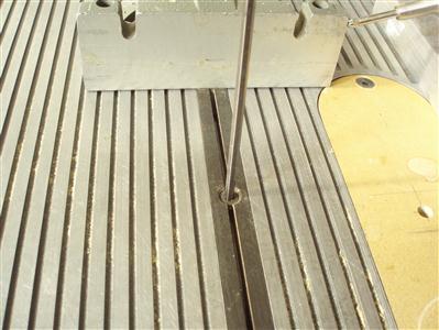

tew648: (continued)

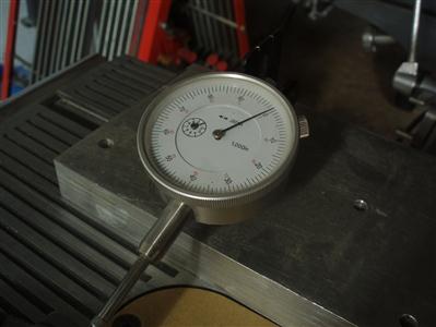

These images were taken after the taper screw was adjusted. The adjustment was made until the miter bar just began to tighten up in the miter track. Just a little tighter and the bar would be locked solid in the track.
The result can be seen in the last two images.
[ATTACH]18742[/ATTACH]
[ATTACH]18743[/ATTACH], [ATTACH]18744[/ATTACH]
You can see that the slop has been reduced to .004"
CONCLUSION: The Shopsmith Miter Bar and Miter Track are milled with adequate precision to provide the needed accuracy. If yours (on the Cross-cut Sled) doesn't perform in this matter, I would recommend that you contact Shopsmith for further guidance.
If you do not have a dial indicator, the same sort of test can be run using a set of inexpensive feeler gauges available at any automotive store.
