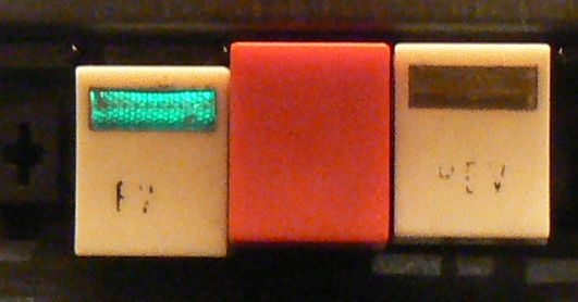

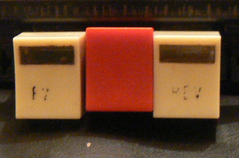

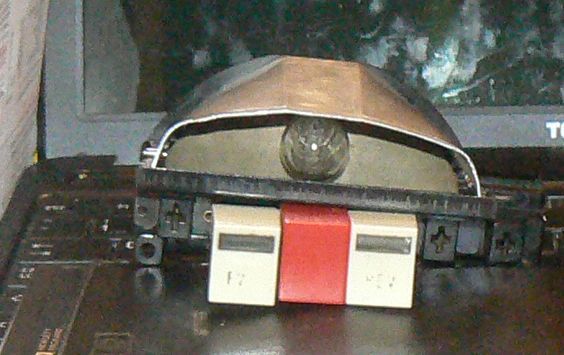

Mark VII power switch
The power switch has power on indication. When off, no light.
power off.jpg (74.06 KiB) Viewed 5922 times
When running forward, a green light 'lights'.
When running in reverse, an amber light 'lights'.
The pilot lamp is an 'S6' bulb. I found thisun at HD, 2/$2.??.

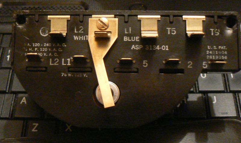

Wiring side of switch.
wiring side.jpg (80 KiB) Viewed 5951 times
Line cord wires attach to lower 'L1'(black) and 'L2'(white) terminals.
For A.O.Smith motor wires connect as follows: (507231)
Black 'L1' (upper)
White 'L2' (upper)
Red 'T5'
Red Tracer 'T9'
Yellow '5' The two '5' switch terminals are jumpered.
Black tracer '2' from capacitor
Black tracer from motor to other capacitor terminal
For General Electric motor wires connect as follows: (507232)
Line cord wires as described above to lower L1,L2.
Blue 'L1'
White 'L2'
Red 'T5'
Black 'T9'
Purple '5' The two '5' terminals are jumpered.
Orange '2'
two brown wires(one to each capacitor terminal).
For A.O.Smith motor with an external start relay (501210)
Line cord wires as described above to L1/L2.
Black 'L1'
Whjite 'L2'
Red 'T5'
Red tracer 'T9'
Yellow relay(5) and both '5' switch terminals
Jumper from switch '2' to relay(2)
Black tracer from motor to one capacitor terminal
Black tracer from other capacitor terminal to relay(1)

I bought this style switch from Battle's Hardware in Whittier, CA. ShopSmith actually referred me to Battles for a replacement switch. Apparently, Battles misplaced the wiring diagram that goes with the switch. I'm hoping one of you bought the same switch and can send me a copy of the wiring diagram. I have the GE motor.
abrincks wrote:Image
Do you have a R13-44-E-01?
Does the GE motor have the external start relay?
abrincks
Bronze Member
Posts: 4
Joined: Mon Nov 03, 2014 11:27 pm
Post by abrincks »
The number on the switch is not that specific. It is supposed to be an on, off, reverse toggle. How would I be able to tell if the motor has the external start relay? Initially I thought the Mare VIIs only came with 2 motor possibilities, the GE and one that slips my mind.
abrincks wrote:The number on the switch is not that specific. It is supposed to be an on, off, reverse toggle. How would I be able to tell if the motor has the external start relay? Initially I thought the Mare VIIs only came with 2 motor possibilities, the GE and one that slips my mind.
The start relay is mounted on the case of the motor.
GE, A.O.Smith, A.O.Smith with relay.
What are the wire colors coming out of the motor and number of each color?
Assuming the switch has three detented(not spring return) positions it is likely an "E".
A word of 'caution' - The motor MUST be allowed to coast down if running in one direction, and you need to reverse it. The switch only alters the start circuit. If you reverse it with the motor running, it will continue to run in the original direction.
Wire colors?
Never mind, you said GE Motor.
So verify the wires are:
Brown (2)
Orange
Purple
Black
Red
Blue
White
