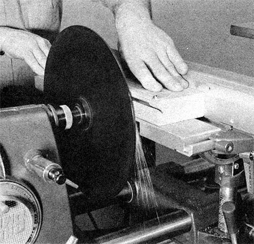

I seem to find myself intrigued with jigs, and since I am a novice, think that this might be a phase of woodworking for beginners like me. I am going to try to make these jigs to sharpen my jointer blades. The first image is a jig designed for honing, the second and third is hand made jig used for first stage sharpening on the disc sander.
I have had little success over the years with sharpening, but have received a lot of instruction off this thread. I really like the glass idea with the six grades of sand paper glued to it that I found here. http://www.woodsmith.com/magazine/extra ... harpening/

I recently made the Shopsmith jig version with great success on 6inch craftsman jointer blades. It was a Craigslist deal for $50 in good condition just the blade were nicked but have never been sharpened so I saw I could do it with my Shopsmith and gave it a go two light passes and the nicks were gone then I just honed the with 600 grit sandpaper on a marble tile. Been using the newly sharpened blades for about 2 months on a regular basis still sharp. I made the block with a 43 degree slot, that's what my blades bevel was. Good luck
Any questions just ask.
