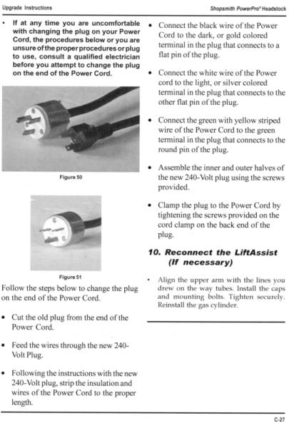

Duel Voltage plug for Power pro
Would someone with a PowerPro that was wired by Shopsmith to run on 220 vac, please post a picture of the power connector on the PowerPro cable.
For educational purposes only.
[ATTACH]18962[/ATTACH]
shopsmith manual power conversion small.jpg (36.61 KiB) Viewed 1759 times

dusty wrote:If I had a PowerPro:( I would just ohm out the cord to answer this question myself but I cannot.
If the PowerPro was purchased to run on 220 vac, what sort of connector is required for the power source in the shop. I would assume it has two hots (two reds or a black and a red ), an ac return (white) and a ground (green).
That would be incorrect. It is three wires. Shopsmith recommends a standard 15A 250 V plug like this one. and provides instructions with the PowerPro on how to wire the plug. I used a 20A twist lock like this since that is what I have in my Shop
You don't purchase a 200 Volt PowerPro that all run on 110 or 220 just like your laptop or cell phone.
It is wire the same as a US 110 device one hot, one return and one ground.
Paul Cohen
Beaverton, OR
The powerpro does not come in different versions. Only one version but it will run on either 115v or 230v with greater power output at the higher voltage.
I question the existence of a nickel plated terminal on any 230v plug
(usa).
Realize there are different receptacles for 230v 15A and 20A - the plug needs to match.
The 230v plug in the ss instructions is a 15A version.
The 230v plug in the miller video is a 20A version, and the 115v plug is a 15A version.
The 230v receptacles mentioned above both have two 'hots' and and a ground. No neutral is needed/used.
