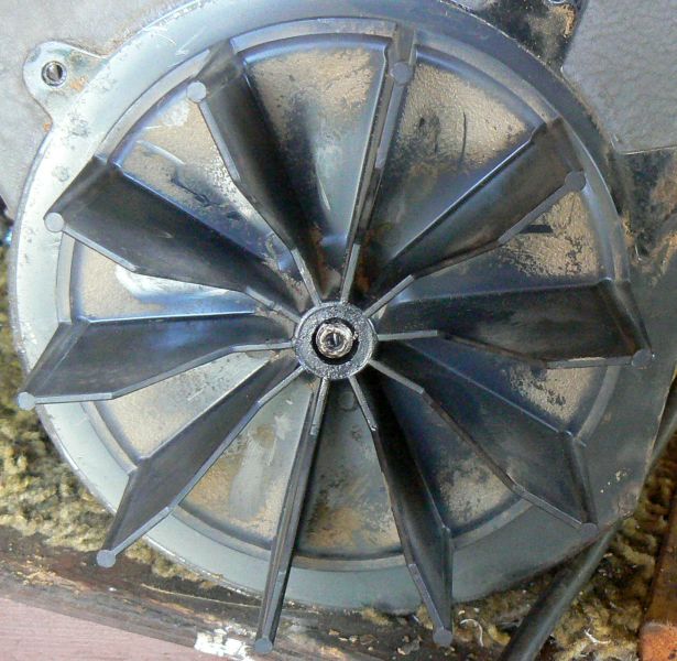

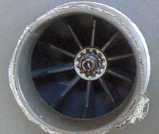

One very distinguishing 'feature' of a Mark VII is the 'vacuum' driven by a shaft from the 'back' end of the motor. This thread describes the disassembly of the vacuum housing etc. from the motor pan.

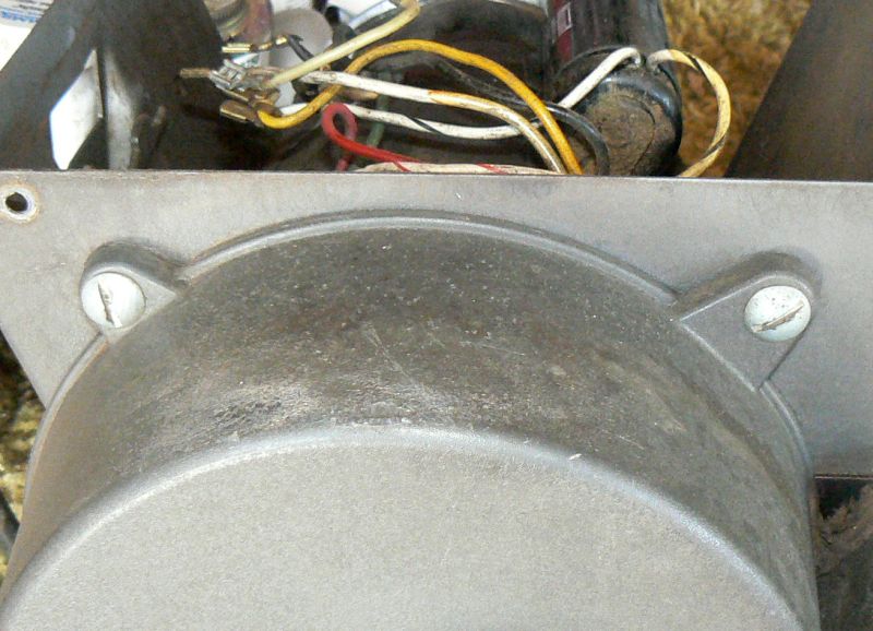

The vacuum housing is secured to the motor pan end with two large headed screws. This housing is plastic and shows some cracking. After all it is almost a half century old.
[ATTACH]18983[/ATTACH]

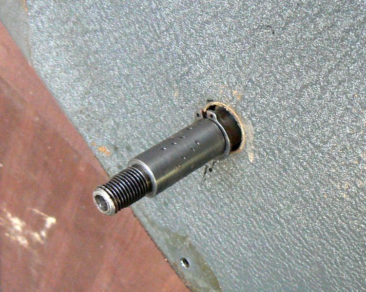

The exit port(s) are screwed to the side of the motor pan.

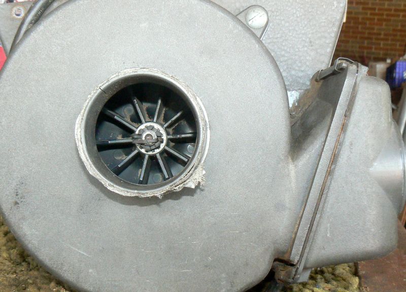

The plastic parts are also held together by these clips.

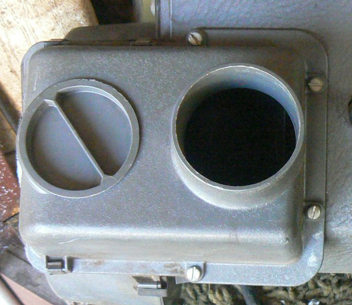

The impeller is secured to the motor shaft by a castle nut and a cotter pin.

Mark VII vacuum breakdown

- blower housing front.jpg (109.22 KiB) Viewed 1418 times

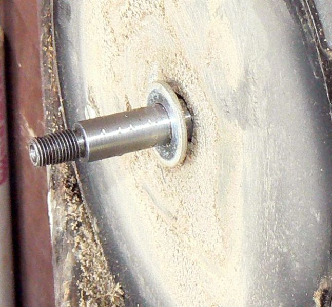

After removing the cotter pin, the castle nut was removed. An external tooth lock washer and flat washer were behind the nut.
