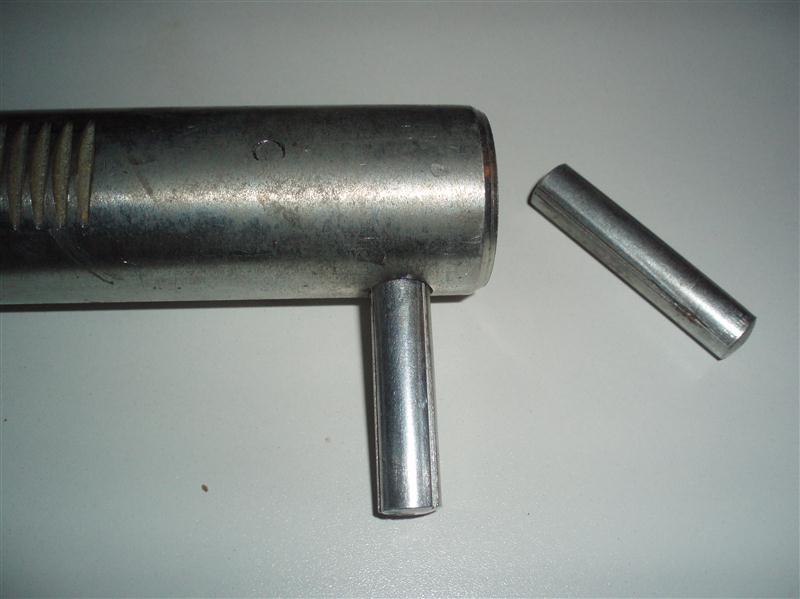

I don't think that I would "fool around" with a tube and tie bar assembly that I intended to use but the legs can be removed and reinstalled without loosing functionality.
I have removed the legs from a tie bar assembly so that I could rotate them 180° and reinstall them. I was experimenting with the idea of rotating the table like in "double tilt". Those same legs and tapered pins have been reinstalled in their original configuration.
Bottom line - this can be done if you really want or need to.
[ATTACH]19418[/ATTACH]
The pins are designed to be pressed in and out. If you can do that, it is best that you do. If you must drive them in and out, don't beat directly on the pin and back up the tubes else you do damage to the cross bar.
The gorilla will certainly loose this battle.
