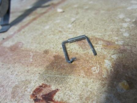

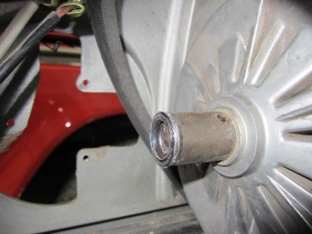

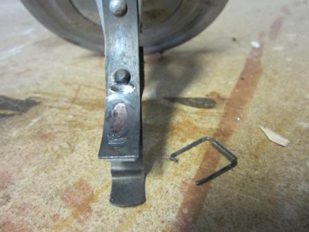

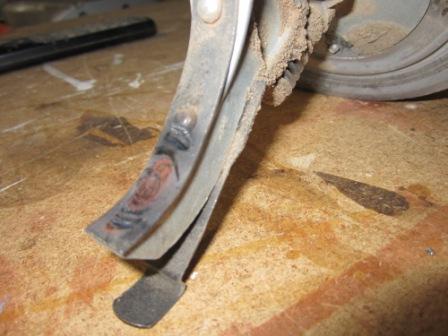

Here are some pics of the control sheave and speed control. The square clip fell off as I was taking it apart and I noticed it was melted where it broke off.
Thanks for the help

gogreenwave wrote:Here are some pics of the control sheave and speed control. The square clip fell off as I was taking it apart and I noticed it was melted where it broke off.
Thanks for the help

Interesting! It appears one does not need the bearing/button after all.
The porkchop can be cleaned up(smooth out those bumps), but the control sheave is essentially toast(yes there are ways, but beyond the 'typical' SS owner). The 'clip is broken. A new one will come with a new control sheave.
The 'burned' look of the steel plate riveted to the porkchop is normal.
