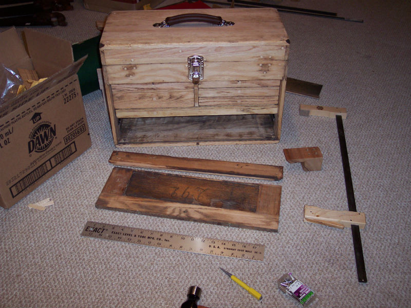

Now I'm starting to get somewhere on the 3rd one. I bought it a few months back as an "old cube of grease," with the back-panel warped out of attachment, and various other troubles. I did a whole lot of hand-planing and scraping to get back to bare wood. Also I counted about 51 hole-plugs that I made with the Mark V. Each place needing a plug (each old rivet-hole) was drilled-out with a little block of wood used as a guide for my hand drill. I also made use of Shopsmith's long cam-clamps to hold parts in alignment for reassembly and drilling new hardware rivet-holes:

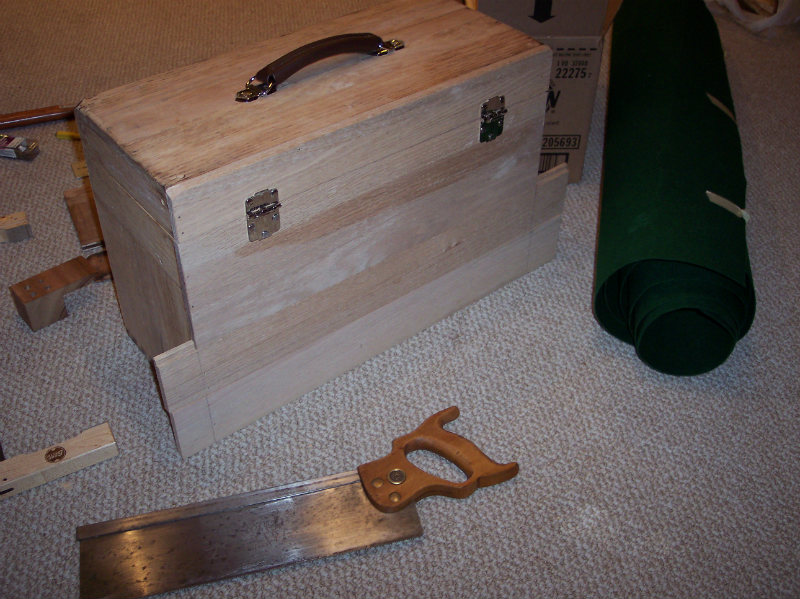

As mentioned on another thread dealing with accurate sawing, these old chests really don't work well with solid backs -- they'll always crack or warp with humidity changes. In fact the premium grade chests often use plywood for the back, like this nice little kit:
http://www.stewmac.com/shop/Kits/Tool_C ... t_Kit.html
I like to use lapped boards with a little bit of gap to make the replacement back. And, often as not, something isn't totally square so I really waste time to try to pre-cut the board exactly to size. I just install the board "long" and then have fun manually cross-cutting it. In principle I don't often use handsaws and "[plane] shooting boards" for general work, but if something is built like this then it's very fun to trim it down to a nice flush mate.:

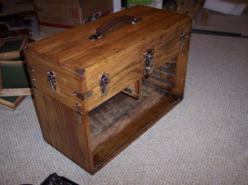

I wanted to try out some finish and stain work to see if the iron stains on the front would be less obvious. Between some color and some new locks, luckily it came out pretty well....
I also added not only some corner-straps to match the original construction, but also some extra "vise flattened" straps to help hold the cross-grained unions which previously had caused trouble and wood breakage. I decided to leave those tongue/groove joints "dry" (no glue) and reinforce them with straps so the chest would be strong when lifted by the handle:

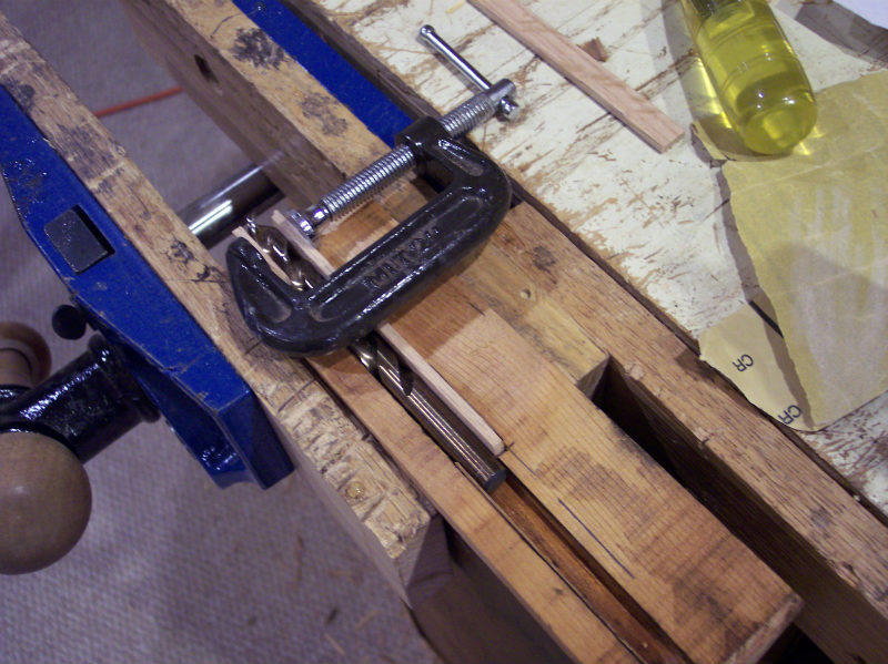

Next, I have to repair the side grooves in the bottom (biggest) drawer, which had been worn very wide. Here I managed to fit some hardwood strips for repair, and used a 3/8" drill bit to get things decently spaced and clamped for the glue:
[ATTACH]20164[/ATTACH]

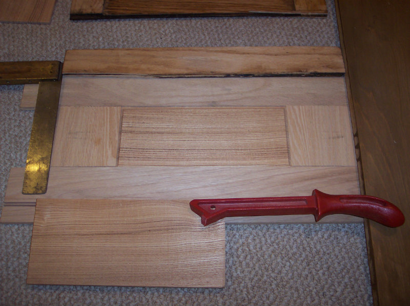

I put a lot of narrow grooves and rabbets on the oak planks using 1 kerf width on the SS table saw.
For the middle panel, I used what I believe is Kentucky Coffee Tree wood; I've had it for a long time. I used the bandsaw for resawing, and the overarm router to profile the edges.

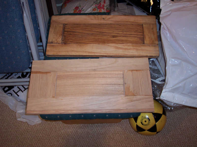

Here is the new front-panel "in white" compared to the broken original with its very flimsy, ill-proportioned center panel:

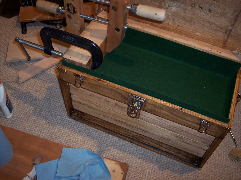

Here begins the time-consuming process of gluing new lining into all the compartments. I just use white glue and carefully clamp each operation. I believe the Gerstner & Sons factory still uses hide-glue. I suspect hide-glue would dry faster and have less need of pressure clamping, so they know what they're doing. Anyway, I'll keep plugging the slow way...
[ATTACH]20289[/ATTACH]
[ATTACH]20290[/ATTACH]
