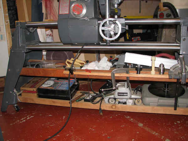

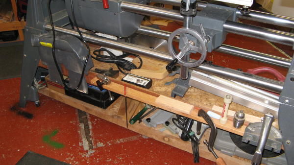

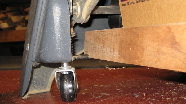

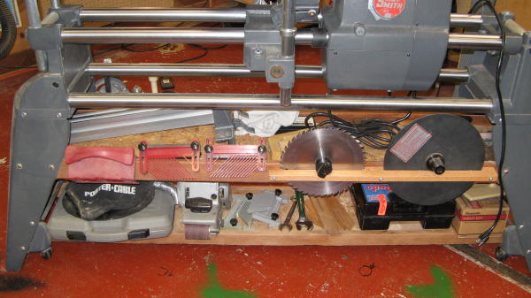

Here's my approach. Not as much storage but easy to make and very flexible. I've remade the outer tool holders 2 or 3 times. (I can provide current pics and some construction detail if you're interested.) Basically the racks are rails with a grooves cut for a particle board shelves. The upper is attached with threaded inserts to the SS legs and the lower sits on the metal stretcher on the legs. (mine is a 500)
I think building some kind of storage unit, that fits your needs, is well worth the effort and cost. Work on it this weekend.

- accessory shelf 1.jpg (30.67 KiB) Viewed 4911 times
- accessory shelf 5.jpg (53.6 KiB) Viewed 4931 times
- accessory shelf 9.jpg (57.46 KiB) Viewed 4909 times
- accessory shelf detail 2.jpg (44.07 KiB) Viewed 4906 times
