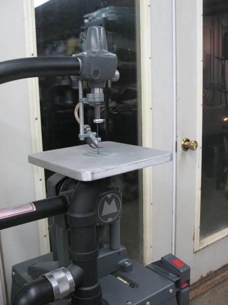

First, here's a photo of my jigsaw, on a power stand. https://dl.dropbox.com/u/17737602/IMG_9004.jpg It certainly appears to be the same vintage as the subject in question. I did add the black-painted PVC dust-collection tube -- that works great.

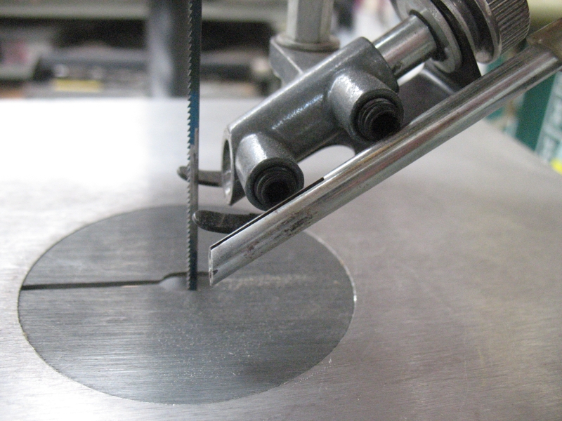

Next, here's a closeup of the upper blade guide, backup tube, and split tube, adjusted and ready to go. https://dl.dropbox.com/u/17737602/IMG_9005.jpg
Now, here's a closeup of the split tube, taken from an angle similar to ertigas' photo. https://dl.dropbox.com/u/17737602/IMG_9002.jpg The length of the split appears to be the same.
Here's a closeup side view of the split tube. https://dl.dropbox.com/u/17737602/IMG_9003.jpg On this vintage jigsaw, at least, the split clearly extends back past split-tube setscrew.

Thanks for the self explanatory photos. Now here are my conclusions.
1) My inner tube seems not to be straight and considering the crack on the cast it may have been forced by the previous owner.
2) The tube is the original size and has not been modified, other than forced beyond its elasticity limits (arguable but seems logical to me)
3) I can replace it with a home made stainless steel part, at least for the fun of it : )
I m going to be in Pastaland (Italy) for s couple of weeks but upon my return will order some metal and try to make a new part.
I'll have to deal with the crack in the support sooner or later although Shopsmith lists that part as available and I already ordered one. I want to experiment with aluminum brazing so this could be the chance and the possibility to fix the cracked part and a few others I have accumulated.
