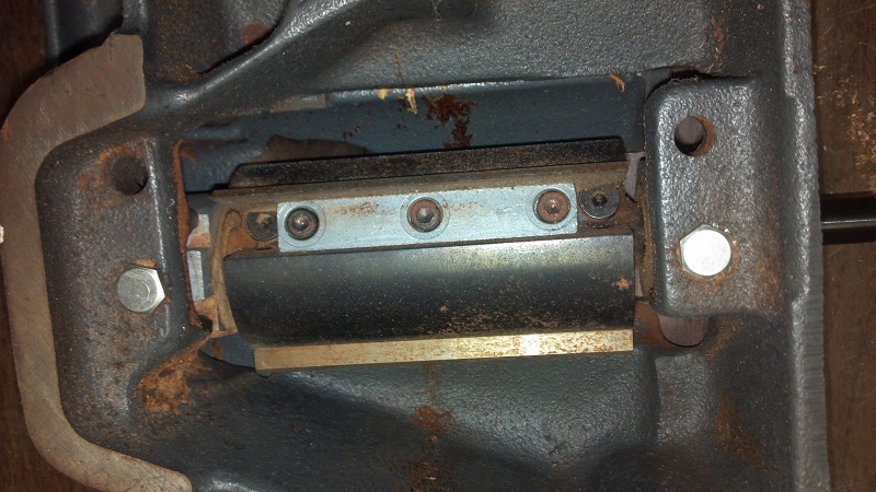

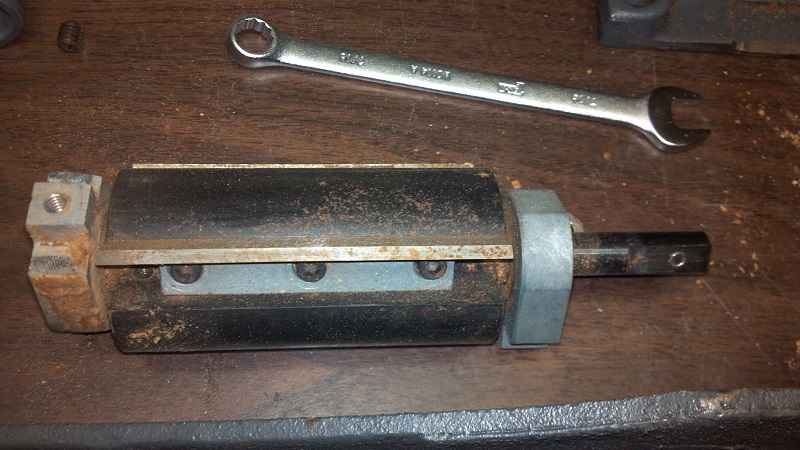

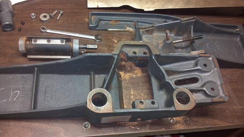

Hi all, starting to clean up some of my aquired loot. This is the start of cleaning up the jointer. I've already cleaned up the belt sander fence and bandsaw table to stop anymore rust to those items. Thought I would take pics and maybe have some questions along the way.
[ATTACH]20689[/ATTACH]

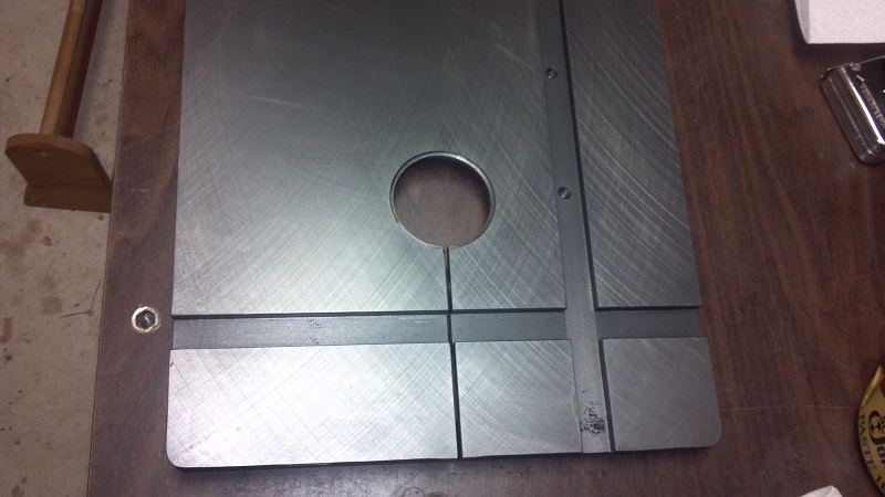

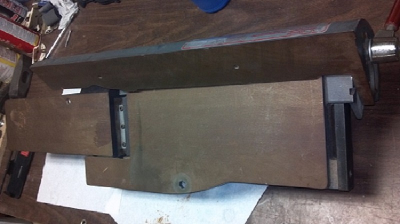

Not horrible rust, but rust non-the-less.
[ATTACH]20688[/ATTACH]
Not very difficult so far. I wonder what the extra 2 holes next to the 2 where the jointer knife drum is attached?

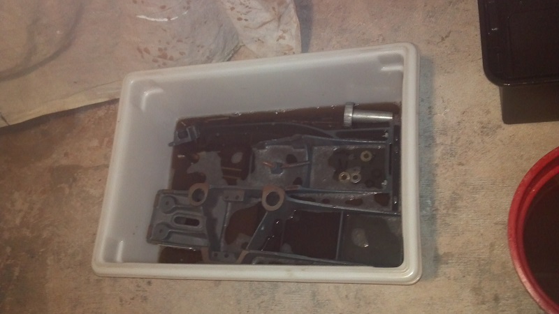

Going to be using EvapoRust to clean the rust. The longest piece is 22 inches long, so had to find a flat bottom square tub big enough.
Only able to use 1 gallon of solution (EvapoRust is not cheap), so the level is rather shallow. The large pieces can't be totally submerged, so will need to be turned for another soaking.

[ATTACH]20690[/ATTACH]
small parts.... some of them will need cleaning by hand

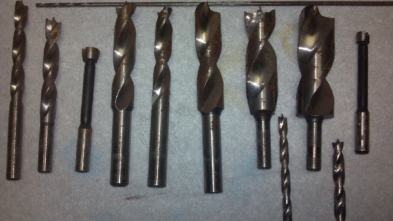

[ATTACH]20692[/ATTACH]
Might as well make good use of the extra space in the Vapo bath.
[ATTACH]20691[/ATTACH]
Letting it set overnight and work on it in the morning

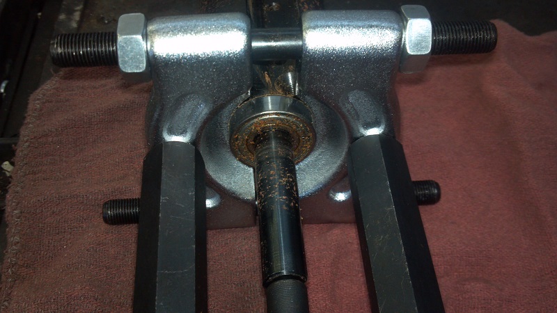

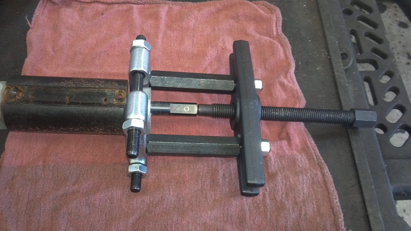

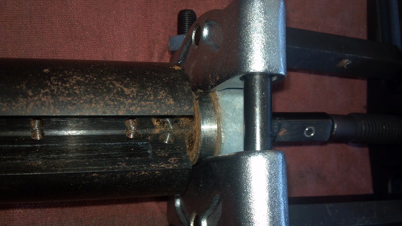

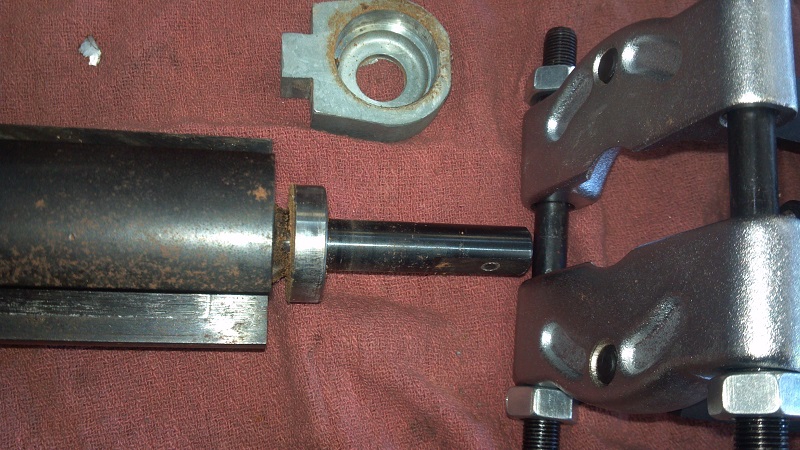

Anybody ever replace those bearings in the cutterhead? Looks tricky!
- Posts: 21481
pieceseeker wrote:Anybody ever replace those bearings in the cutterhead? Looks tricky!
I attempted to and ended up replacing the cutter head with a new one that came complete with bearings. I bent the shaft in the cutter head while attempting to remove bearings..
With that experience, I shall decline giving any advice. The cutter head is not cheap.
Properly equipped, it seems like a simple task.
- pieceseeker
- Posts: 370
- Joined: Mon Jan 07, 2013 12:13 pm
- Location: Lawrenceville, Georgia
I have access to a press and many different bearing pullers at my work. I may take a closer look once I'm done with cleaning and waxing.dusty wrote:I attempted to and ended up replacing the cutter head with a new one that came complete with bearings. I bent the shaft in the cutter head while attempting to remove bearings..

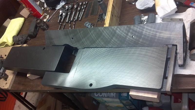

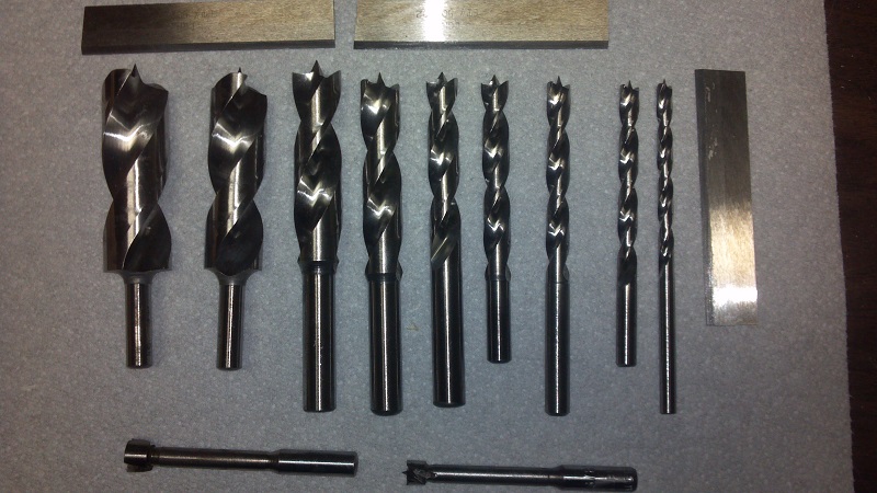

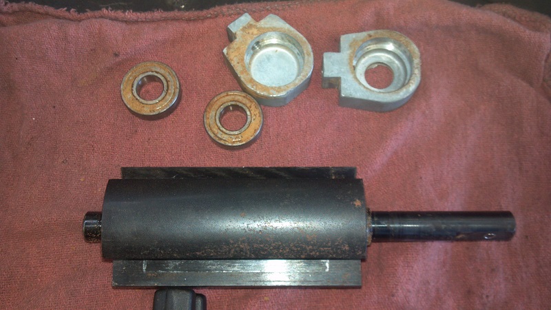

My progress today!
[ATTACH]20706[/ATTACH]
[ATTACH]20707[/ATTACH]
That amazing EvapoRust takes a lot of the work out of rust removal. A little elbow grease with a stainless steel brush from Harbor Freight after soaking for several hours really does the trick! It does no harm to paint, easy cleanup, non toxic, what more could you ask?
