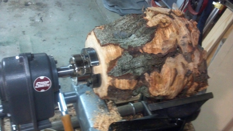

Forgot the Photo
[ATTACH]20515[/ATTACH]
Dead Plum tree removed

It may never get completed!
I pulled it off of the lathe 3 weeks ago as I had some other projects that needed attention. That may have been a mistake. I can see where it has started cracking as I did not get it hollowed out and it still had the pith in it.
I may try to save it but its future is uncertain at this point. I was also running into rocks in the root structure. I thought glue from laminated wood was hard on tool edges. The next time you hear some say. "This wood is hard as a rock" ask them when the last time they tried cutting rock was. Turning a root ball is not for the faint of heart. The good news is that the other timber harvested and processed is seasoning nicely with minimal checking so far. It will be quite some time before anything gets done with that wood though, it will need several more months at least before I can attempt anything with it. I'll try to post some pics of the cracking tomorrow.
Those of you wanting to turn green wood. Please note that you must commit to the turning completely or risk losing the blank.
What can I say, SWMBO wanted those drawers in her kitchen more than "Another stupid bowl", Drawers are done waiting for install (maybe this week), I even reconfigured my shop to make it easier to work in and clean. Spring yard projects are taking precedence as well.

I have a question. First though, realize I have not done any turning on my ShopSmith other than a quick "try it out" session.
I thought I saw somewhere that if you turn a bowl with wood that was not first dried, the bowl will crack when it does dry out. Am I remembering that incorrectly? Just curious.

Bowls are often turned green. And yes you do run the risk of them cracking.
There 2 basic schools of thought when it comes to green wood bowls
Green wood cuts much easier on the lathe than dry wood.
Method 1 Turn the bowl to a wall thickness approximately 10% of the bowls diameter and let it dry out. Typically as long as the pith is removed it won't crack too badly. It will warp some but the exaggerated wall thickness gives you enough to true it up once it's all dry. Once it's dry do the finish turning and final finishing.
Method 2: turn to final dimension and let the bowl warp and crack. It will dry faster than method 1. Once it's dry, do the finishing by hand, warts, bends, cracks and all, very artistic.
I've done both methods.
