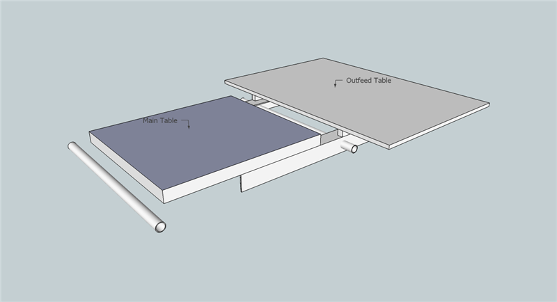

camerio wrote:Where is the Mark5 table on your design ?
I think this will answer your question (hopefully for all those versions I have posted).
[ATTACH]20725[/ATTACH]
A Main Table with OFT that Tilts version3 (Custom).png (47.45 KiB) Viewed 2106 times

dusty wrote:I think this will answer your question (hopefully for all those versions I have posted).
I see now where we stand ... thanks Dusty .. Keep on
