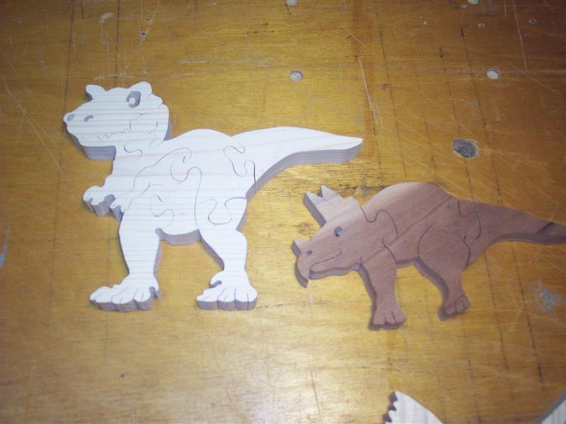

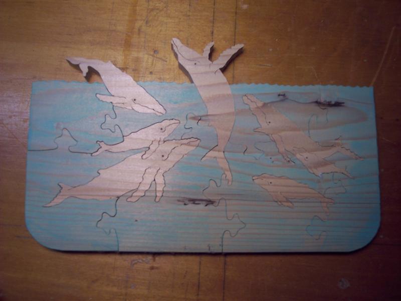

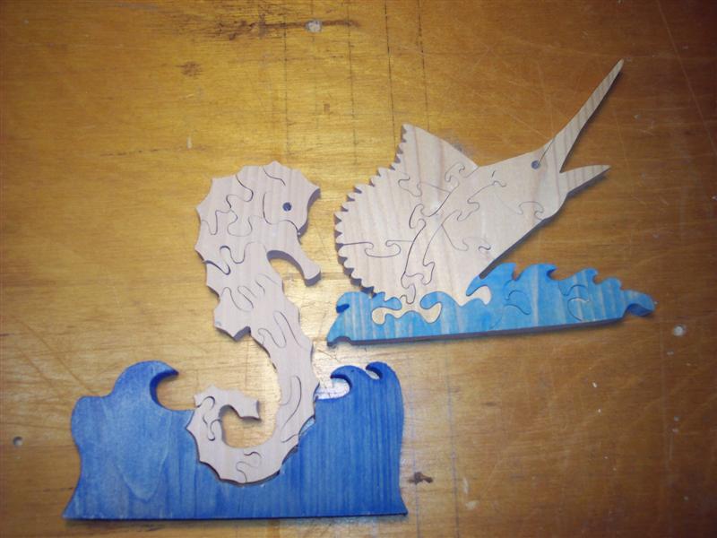

So after the minor prep, it was simple enough to square up the blade to each table and start playing. For all the projects on this first round I used Pegas #7 reverse skip tooth blades. Wood was pine, redwood, and hemlock. Just some scrap I had laying around. 3 projects per saw but one was wisked away before I could get a photo.[ATTACH]20720[/ATTACH][ATTACH]20721[/ATTACH][ATTACH]20722[/ATTACH]
