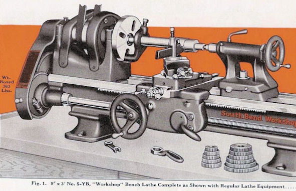

Interesting!
Not only an intelligent response from a seller, but apparently it IS possible to change a listing 'title'.
I think it is actually a 6" drive (also called "dog") plate for a metal lathe. Looks like the ones that fit my 1.5" x 8 tpi South Bend lathe spindle. Here is a pic of one in use from an old catalog:
[ATTACH]21145[/ATTACH]
- drive plate in use.jpg (60.98 KiB) Viewed 1390 times

Well, I wondered about the 6' part based simply on the nominal shipping cost (about $5 as I recall). I could see that shipping for a 6" part. Besides, at 6' diameter the weight would be in the hundreds of pounds. I agree with Prmindartmouth as to what it actually is.
