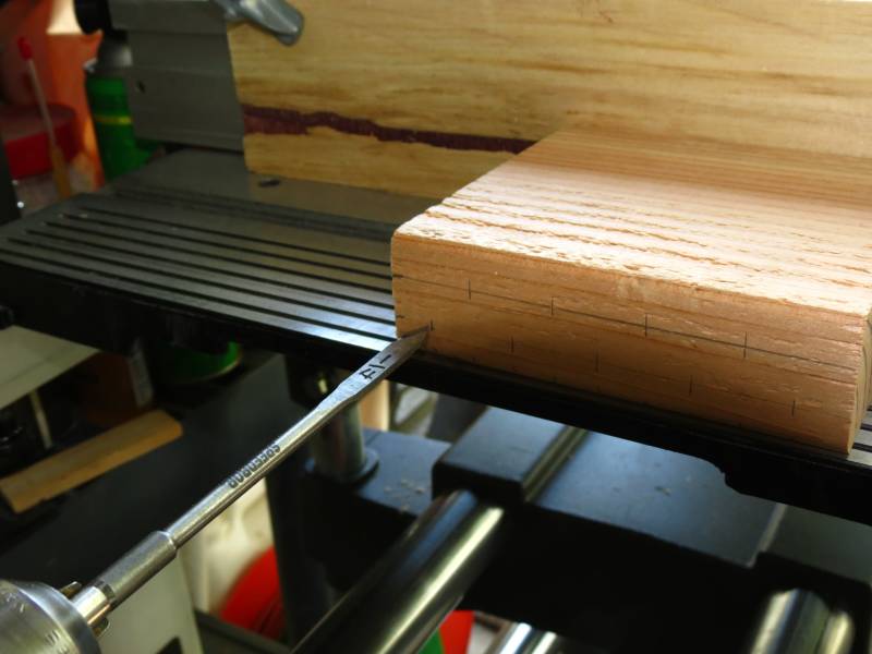

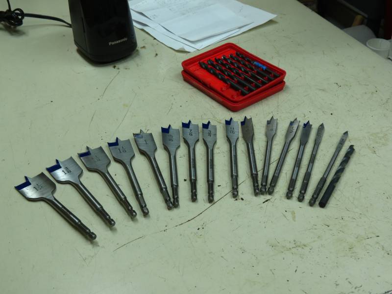

To start with you need a 5/16" drill bit. Some people go bigger and some smaller but I went along with the 5/16" crowd. I wanted to use a spade bit and my larger set has one that size. (Some day I need to make a storage system for those bits).
[ATTACH]21386[/ATTACH]
The spade bits are also a bit longer, note the twist drill to the left. That sound like a good thing for this project.
For the hole locations I came up with the idea of drilling one set then flipping the workpiece and doing a second set. More guess work here, it sounded good so I went with it. I used a center finder to set the height of the main table, in horizontal mode.

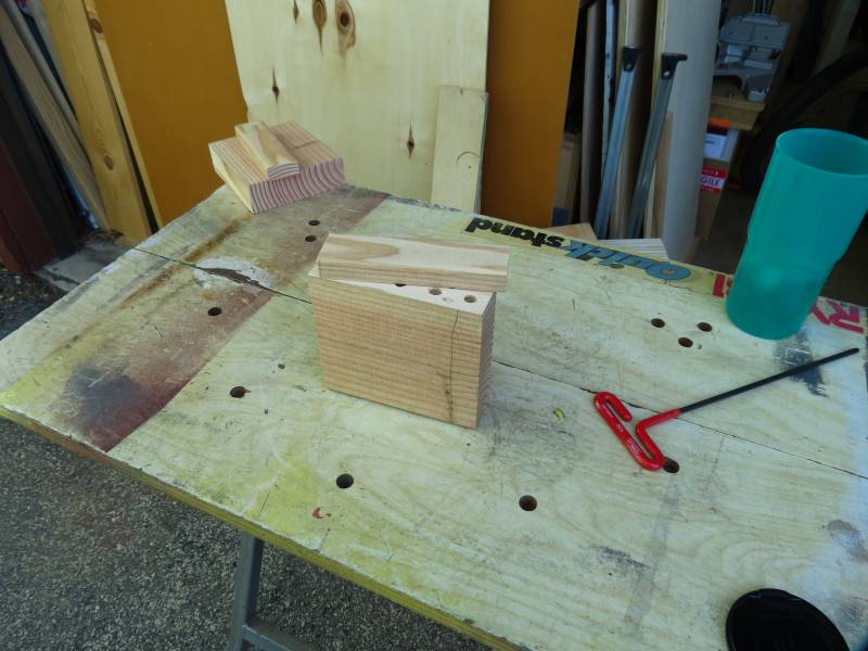

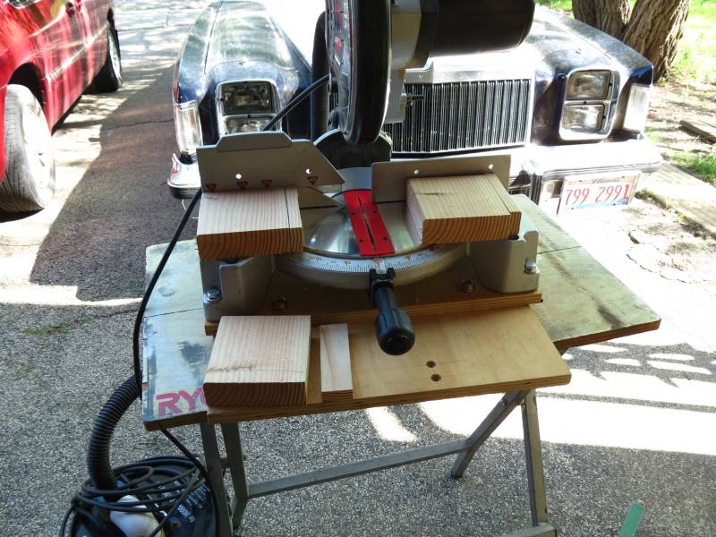

The wood was some left over 2" x 6" pieces. I cut them about 5" long so I could get three of them out of the piece of wood. I did one additional cut on each piece, taking about a 1/2" off in the direction of the grain. This will be reattached when the project is finished. The reasoning is that I can drill through holes by coming from each side rather then just deep holes. I don't think the bees will be to upset, they will pretty much be left in the dark.

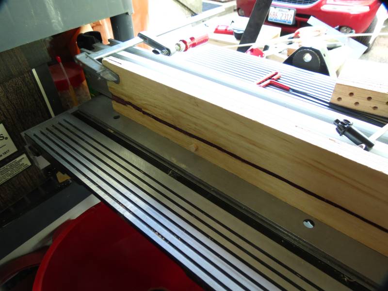

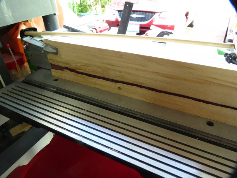

At this point I added and indexed a sacrificial board to my fence. Made sure the depth stop was set so the bit would not drill the fence but still make a hole in the wood.

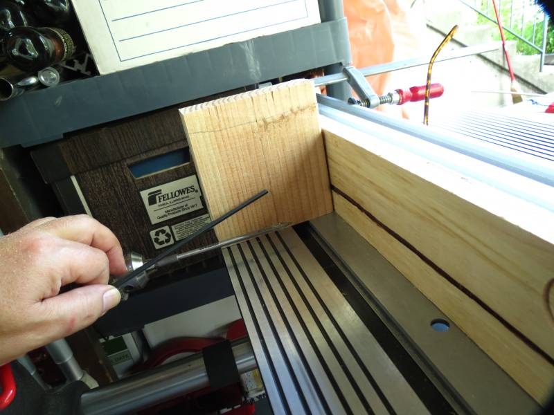

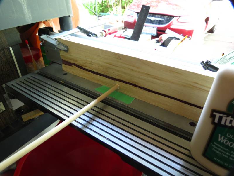

Next I glued a 5/16" dowel in the hole. I put some tape down just in case, no need for any glue clean up.....
[ATTACH]21390[/ATTACH]
After the glue had a while to dry I use a saw to cut off all but about a 1/4" of the dowel.
[ATTACH]21391[/ATTACH]
The sacrificial fence is then rotated out of the way so the first batch of holes can be made. More on that coming up.

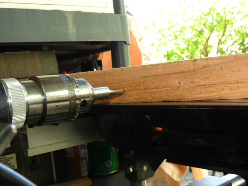

With the dowel pin out of the way it is time to set up do the drilling. Remember to do a depth stop setting that allows the bit to go more then half way through.
[ATTACH]21392[/ATTACH]
Begin by drill the one set of holes then flipping the workpiece and doing the second set. Since I have 3 sets to do I did them all at the same time.

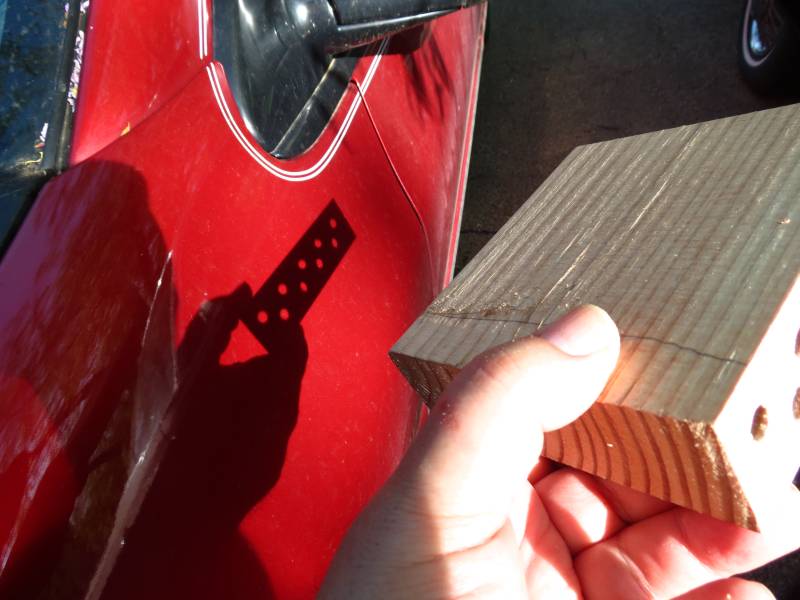

At this point the sacrificial is positioned so the dowel is located on the center line of the drill bit. The drilled holes are now facing the fence and the dowel goes the hole there by indexing the location of the hole from the back side. This second pass makes the holes through holes. Here is a creative way to show that.
[ATTACH]21394[/ATTACH]
You want access to through holes for clean outs, a dowel will rod out the non-hatched from the year before and other unwanted junk so they can be used the next year.

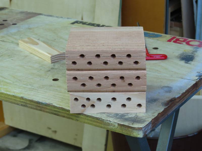

This was my first test of procedure and method. These can be used but I wasn't all that happy with how the end holes. I can see small cracks in the end grain so I think the 1/2" space needs to be more like 1". I'm not all that trilled with the hole patter either. Time to play with sketchup and see what i can come up with.
So what is left to do with this batch is to reattach the backs and stack them together and see how the Mason bees like them. I did have on come visit me while I was working on the project...... A good sigh?
