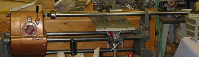

Since making a tube lathe setup for my Shopsmith, I am finding quite a few bowed way tubes. When I had only one Shopsmith, switching the headstock from drill press position to the sawing position, I have had the headstock fall the last foot or two. I believe this may be one of the reasons for bowed way tubes. The Shopsmith Lift-Assist would prevent this from occuring and a good reason to buy it.
allthumbs wrote:I was able to turn the tubes to where the headstock moved much easier, however, when I got to the optimum point, then the carriage was hard to move. I was able to reach a "happy" point with the tubes where the carriage moved with slight resistance and the headstock moved much easier than before. About that time, my wife said it was "time to go" and we departed on an errand for the evening. I'm going to tweak it a bit more this evening. Based on what I saw and felt while moving the front tube, I am sure one or both is slightly bent/bowed.
allthumbs
- IMG_0713.JPG (34.86 KiB) Viewed 14627 times
