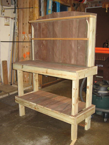

Inspired by Steve at WWMM and decided to make a potting bench.
The frame work is pressure treated 2 x 4's, butt joints with outdoor glue and coated deck screws. The 1 x lumber are (is)? pickets from the fence that blew down during the winter. It's PT also. Given that it's 25+ years old it's in great shape. Size 48" wide and 60" tall. I'm going to put a couple coats of an outdoor stain on it.

It already looks great and solid. Like the design. I'm sure it will get plenty of use and will last long. Great reuse of the fence. Well done!
Super, Berry!:D Nice work!:) Excellent use of old materials! Who in your family does the potting?:confused:

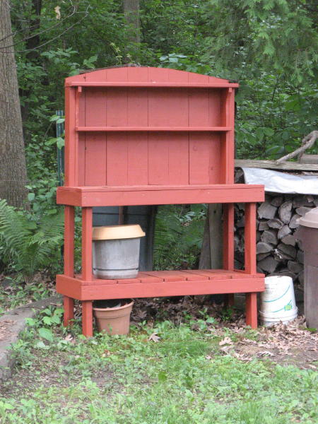

I added a coat of outdoor stain and put it in a corner of the yard near the compost pile.
I'm sure my wife will use this more than I. When it was completed she said, "after 42 years I finally get a work bench of my own."
I did help with some plantings yesterday and I learned two things. Jeeze gardening is tough work and second the mosquitoes are nasty this year.

Nice job! Like the design and I bet it is plenty useful for who ever the gardener is at the moment.
Interesting color, what is it called(who makes etc)? I've been looking for another color for a few things and that just might be it.

Ed it's BEHR (from HD)
Base 5013
SC-330 "Redwood"
It's one of those outdoor stains that is a 'solid', not translucent, more like paint than stain. Water based, easy to work with. I did no prep to the wood other than to vacuum the surface to remove dirt.
