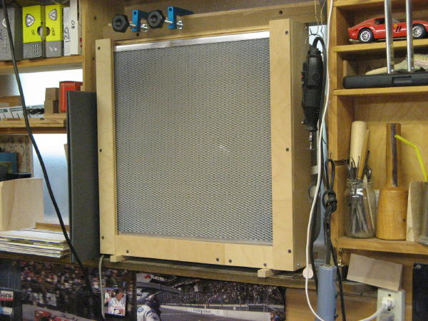

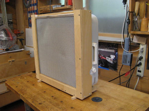

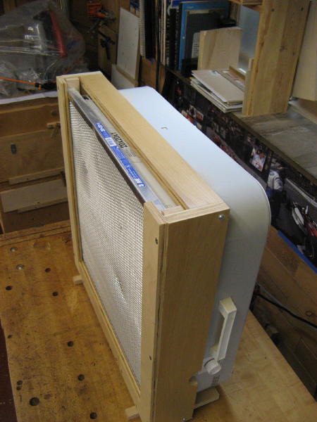

Here ya go. The air is pulled through the filters. The first pic is with the unit in it's home. If I have an exceptionally dirty job I can pull out the frosted inside storm window, open the slider and vent directly outside.da fixer wrote:I'm trying to picture your 20" box fan with 2 air filters...got a pic of it?
[ATTACH]21901[/ATTACH]
[ATTACH]21902[/ATTACH]
[ATTACH]21903[/ATTACH]
- AirCleaner_1776.jpg (72.29 KiB) Viewed 8154 times
- AirCleaner_1777.jpg (52.61 KiB) Viewed 8154 times
- AirCleaner_1778.jpg (64.41 KiB) Viewed 8154 times
