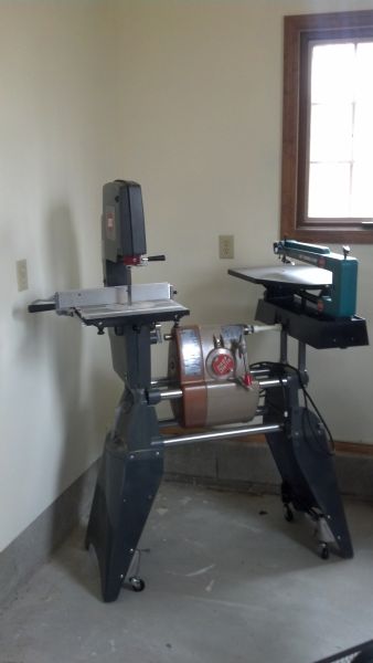

MINI Shopsmith
I do not want to rain on your parade but have you considered buying or building a MINI, 25 5/8" way tubes, Shopsmith. A much wider speed range and you can mount some SPTs on either side plus parts are always available. A reversible motor adds additional capability. Contact me if you have any questions about the MINI and its usages. Thanks.
The motor that comes as part of the Power Station is reversible but what I think Bill is talking about is the motor that would be in a Mini. He can provide you with that because he builds motors for the SS Headstock that are reversible.wasatch wrote:Where would I find more information on the reversable motor you talk about?
ShopSmith Mini
This is a mini that Bill put together for me. I am using my original Goldie headstock that became surplus when I got my PowerPro. Because I mounted my scroll saw on the right side I didn't need a reversible motor. The scroll saw can operate in either a clockwise or counterclockwise rotation. When I ordered it I mentioned to Bill that it didn't need to be showroom quality, but he just can't help being a true craftsman who takes pride in his work.
Dick
[ATTACH]22310[/ATTACH]

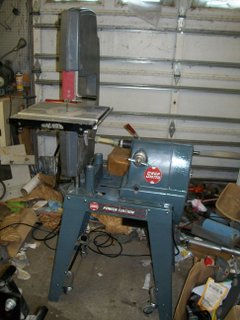

Mark V Power Station
I was finally able to get the pictures of my Mark V Power Station to transfer.
I had the remains of a Power Station for a few years that I had planned to use a Mark V headstock in place of the existing damaged headstock. I was able to accomplish this task and am pleased with the results. I am using a reversible 3/4 HP motor on this Mark V Power Station.
[ATTACH]22333[/ATTACH]
[ATTACH]22334[/ATTACH]
However, I am very disappointed with the capability of my first Power Station comparied to the MINI Shopsmith. For the slightly larger stored space, the MINI gives me more functions and capabilities. I would not recommend anyone doing this conversion or buying a Power Station when the MINI is a much better solution. I will need to sell this unit and build another MINI which will serves my future needs much better. Adding the sawing function will be more difficult to do on the Power Station whereas it is a much easlier task to accomplish for the MINI. I can now see why the Crafter Station was not a big hit for Shopsmith. The same setup will work much better on the MINI with more overall functions and capabilities. The SHORTY allows even more functionally than the MINI but does require more space.
