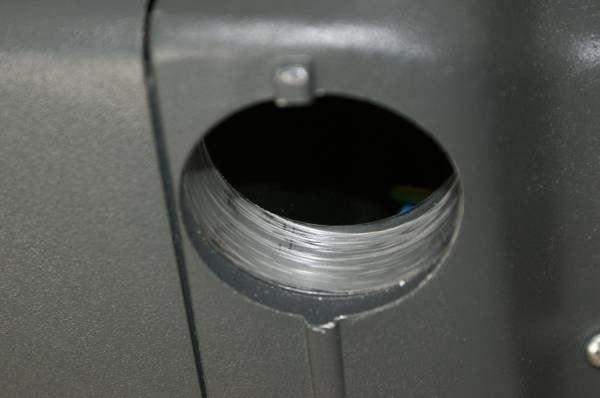

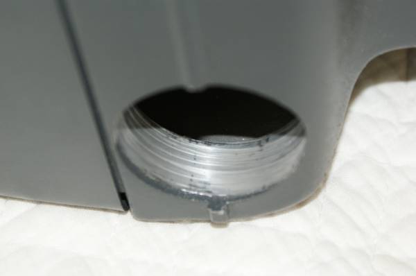

I also bought the entire headstock assembled from SS and I was not impressed with the fit and finish of the way tube holes in the casting.
Both of the photos show the rather rough finish of the waytube bores ofa new headstock. Earlier headstocks have a much smoothre and refined finish on the interior of the bores.
I also had to remove some casting feathers and rough edges with a fine file. I did this on the way tube bores as well as the the quill housing bore in the headstock casting.
[ATTACH]22335[/ATTACH]
[ATTACH]22336[/ATTACH]

- PP headstock bores.jpg (70.6 KiB) Viewed 2354 times
- PP Headsstock bore 2.jpg (64.96 KiB) Viewed 2359 times

Finally got a chance to pull the head back off. Each casting bore looked different. Only one was smooth. One had deep scoring, and the other two were in between. After a light 'honing' with a drum sander it almost slides on the tubes. Not sure where it's still binding at but it's almost usable now. It's not the wedges though. I've got them backed out as far as I can. I went so far as to remove one of the way tubes and it slides through each side smoothly. I guess it may just be the extra weight of the new unit. Hopefully it will get better as it slides around.
