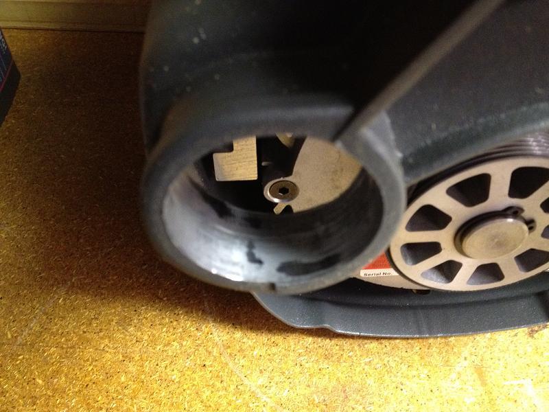

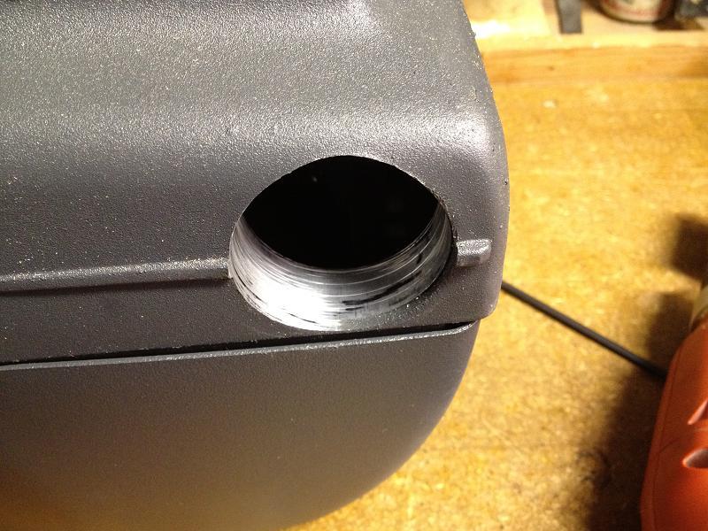

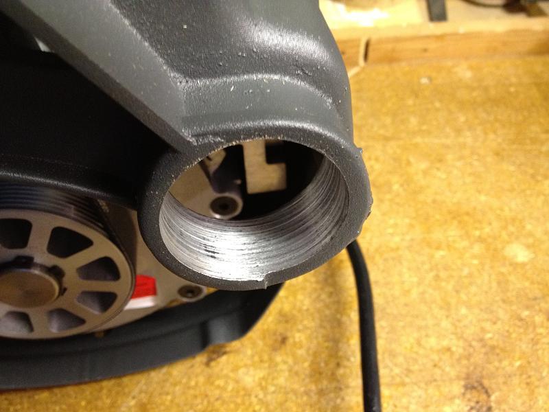

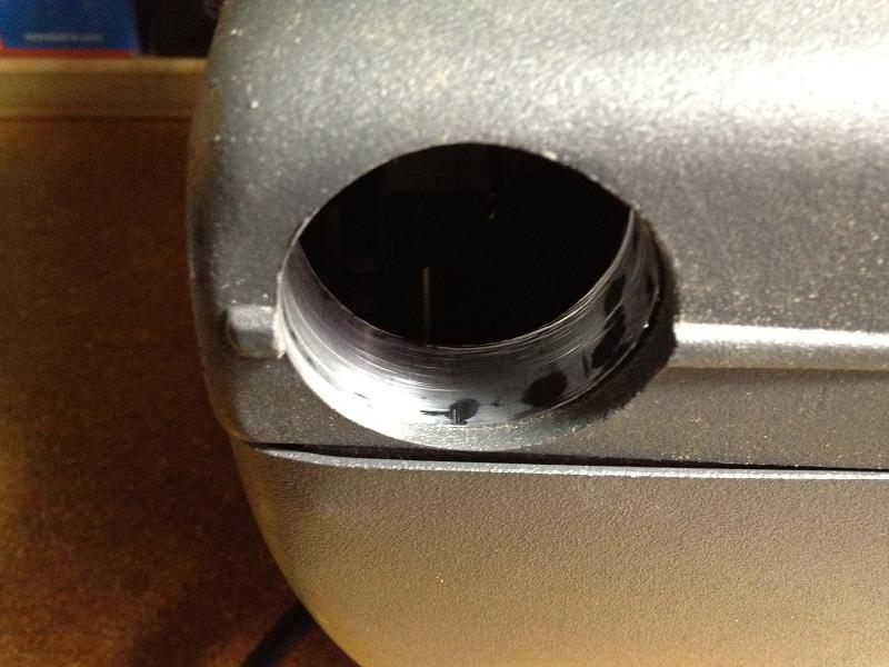

I took some pictures before I started adjusting. Didn't think to take after shots but like I said above it does work a little bit better.

pshortjr wrote:I took some pictures before I started adjusting. Didn't think to take after shots but like I said above it does work a little bit better.
What your pix appear to show is wear marks on the 'bottom!' of the bores. That would likely only occur if binding against the top was occurring.
IIWM, I would inform SS CS of the existence of these pix on the forum, and request further instructions regarding what action you should take.
Although the finish is not perfect(nor atypical:mad: ), I believe the bores are too small top to bottom.
A less likely cause is way tubes out of round or too large(but with no evident history of being so).
