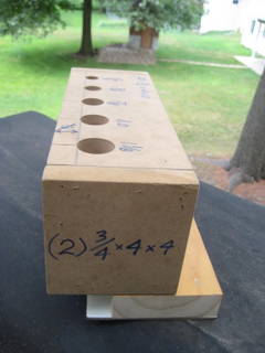

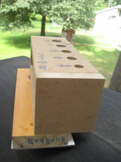

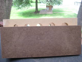

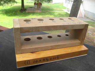

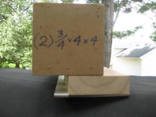

I posted this for Alisfair and inserted the pictures for his German Tendon Jig.
The jig is only 6 pieces made out of OSB or plywood your choice.
(2) pieces 3/4 x 4 x 10 (Top and bottom pieces with the holes in them)
(2) " " 3/4 x 4 x 4 ( end pieces)
(1) " " 1.0 x 3 1/2 x 11 1/2 (offset piece next to bottom piece)
(1) " " 1/4 x 4 3/8 x 11 1/2 ( bottom piece)
Layout holes in the pieces 10 inches long. Draw a line 3/4 of and inch across the end of board. The spacing is not that important but try to make it look nice and even. The one edge of hole must be on or touching the 3/4 line.
Layout the holes starting with the smallest diameter and go to the next one larger. Do not mix hole sizes up .
Tape two 10 in pieces together and drill holes through both pieces at the same time as this will be very accurate. Do not force drill into material as it may make the holes sloppy.
Pull pieces apart then assemble with end pieces using nails, glue or screws.
Assemble the two bottom pieces together noticing the 1/4 piece is over hanging the 1.0 piece, that is good,
Now take and line up the piece that overhangs and line it up on the center line of all the holes. This will be a visual thing but get as close as possible. The closer you are to the centerline the smaller the tendon can be routed. After lining that up secure it nails, glue, screws, I layed out the drilled holes and left the center lines on them so when you place the desired hole by router cutter it will be easier to align the center of tendon. ( a easy. reference set up.)
Watch the video (in German) and look how he sets it up. In order to get the proper diameter of tendon you can try it out on a couple of pieces and then secure it. Once you get it close you can tap it towards or away from the cutter to accomplish this. Once where you want it tighten it down and have fun.
Of course you can put one or more holes in the jig as desired. Just don't mix diameters !
