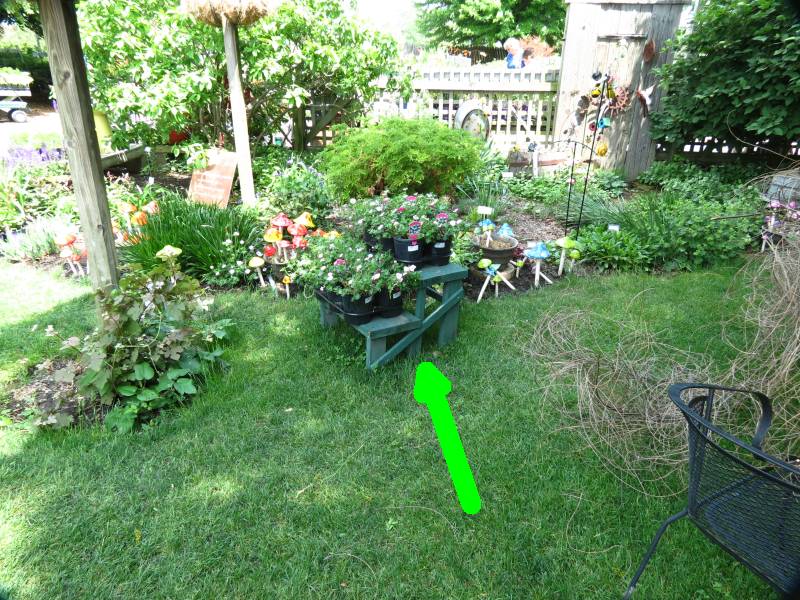

As it has turned out one of my grandsons loves the cistern pump in the back yard. First thing he wants to do is pump some water. He is no where tall enough to do so on his own so someone needs to lift him. Then of course his little brother gets to have his turn....
So add this to my wife spotting this little idea, "plant stand" she liked...

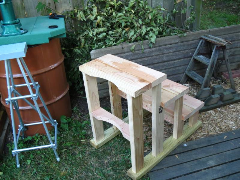

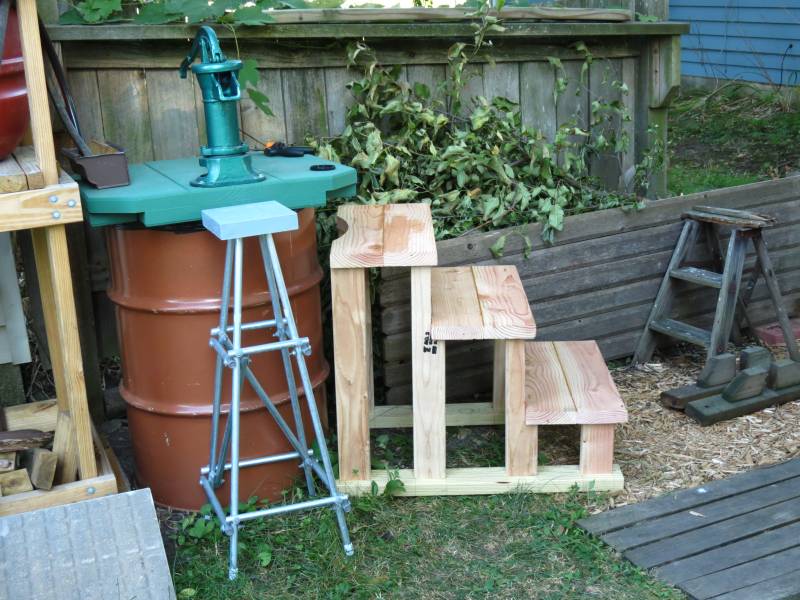

Only one thing a fella can do is in this situation, yep make a Friday project.
The other day I picked up a couple of 2 x 4's at the hardware store (11% off), dug out some 2 x 6 scraps from a long ago project, and added a left over treated 2 x 4 from yet another project and put together a set of steps that will make the cistern self service for the grand kids, a plant stand as needed and utility steps for me sit on and sip an ice tea.
The assembly is with kreg blue coated screws. The runners on the bottom are treated wood so it should go for a few years without any issues.
It still need a few pieces of trim, and paint but the main assembly and construction are done.

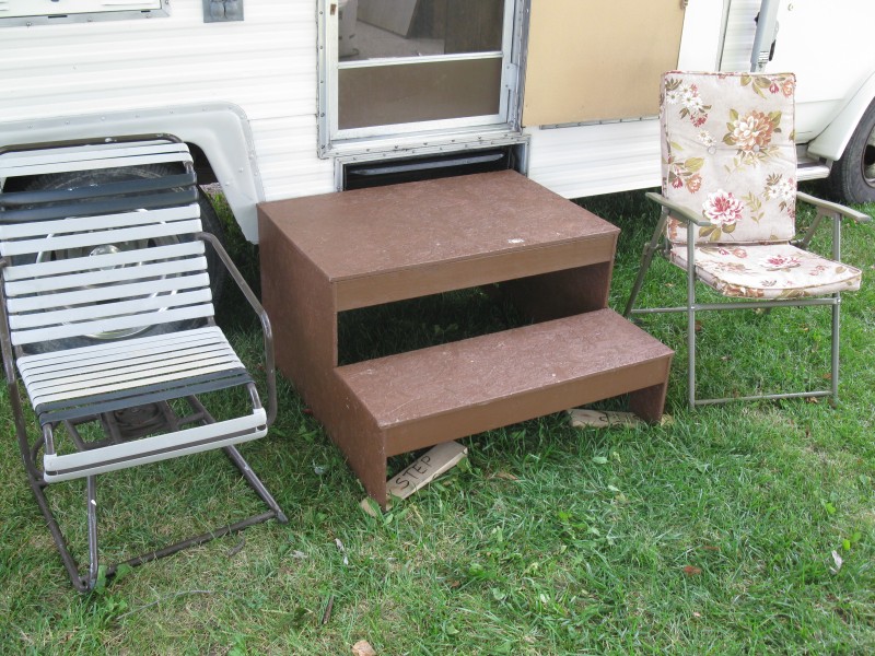

Here is a step I made to use instead of the pull-out RV steps. I don't really like those pull-out steps at all.
I put it together using some 7/16" OSB I had on hand and some other scraps and used stuff. It has braces under both the front and back of each step and 2 smaller supports under the center of the 2' x 3' top platform. To help keep weight down I used a couple of diagonal braces on the back instead a solid panel. It is quite solid and the 2 long flat wedges currently under the front will make it rock stable if the ground is not even.
I made it of odd stuff on hand because I figured I would have to make a couple before I was happy with it but so far I am satisfied. It still gets another coat of paint and a 1" white stripe painted all around the edge of both step platforms. I also have enough 2" wide "grit strips" to put a full length piece near the front of both steps to keep from slipping with wet shoes.
Currently we just sit it up on its heel (back) and turn it side-wise and sit inside of the door and it fits and rides fine there. I have given thought to making it a perch on the over-sized back bumper but haven't made that decision yet.

Boy I wish that first picture was my yard but no such luck.
This is garden center so to speak, called The Growing Place and we love to visit and get ideas and sometimes a plant or two. They are very creative and have a lot of ideas you can buy (or copy). We've seen people bring a lunch and pick out a bench to sit at or sit under a tree. It is more of an experience then it is a "store". They have a play area for small children so they can stay busy, a old farm house that they had moved to the location for nostalgia, lots of antiques stuff as decorations or as part of garden rooms.
