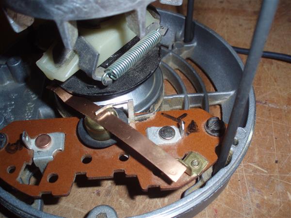

Centrifugal Switch from a Crafter's Station
Does the centrifugal switch mechanism from a 1 1/8hp Emerson look any thing like this?
[ATTACH]22556[/ATTACH]
[ATTACH]22557[/ATTACH]

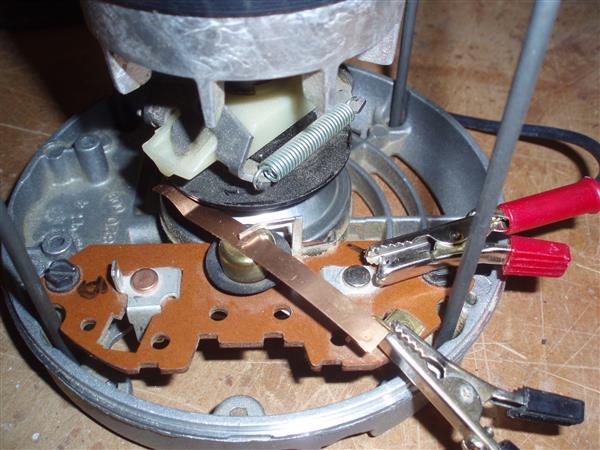

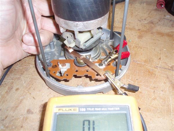

Meter Connected
[ATTACH]22558[/ATTACH]
Switch Closed (no rotation)
[ATTACH]22559[/ATTACH]
Switch Open (motor rotating - simulated switch action)
Centrifugal Switch Metered (Custom).JPG (61.67 KiB) Viewed 2022 times
Centrifugal Switch Closed (Custom).JPG (42.78 KiB) Viewed 2021 times
Centrifugal Switch Open (Custom).JPG (55.32 KiB) Viewed 2019 times

Dusty,
Yes it does and it operates the same way and I see similar performance when I operate it manually. The problem is (I think) the spinning armature is getting stuck (intermittently) and leaving the switch closed, causing bad things to happen w/the capacitor as it would be continuously charging and discharging and most likely overheating.
