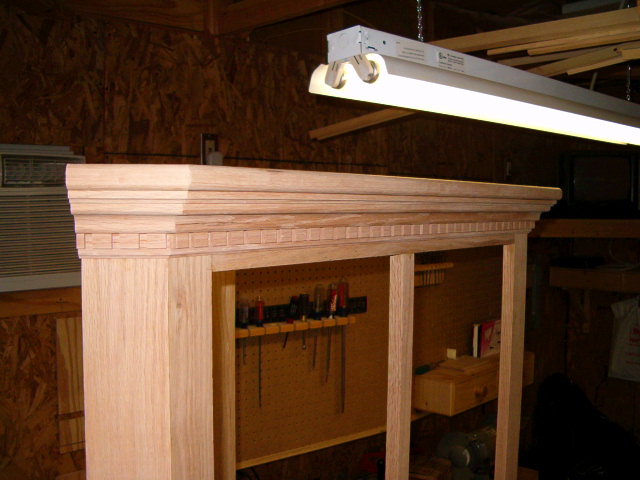

The last time I used the saw with a tilted table was to saw the bevels on the sides, front and rear of my Corner China Cabinet. These bevel cuts were on boards about 3 to 4 ft. long. As I remember the bevel angles were 22.5 degrees and 45 deg.
Now for the discussion of bevel vs. miter: As far as I'm concerned, when the sides of the China Cabinet were being sawn they were beveled. When the were assembled they became miters.
For example: If I had four boards, all 6" wide and crosscut the all ends of these boards at a bevel of 45 deg. - I would have cut 8ea. 45 deg. bevels. If I then assemble these boards end to end - I would have the sides of a 6" high box with mitered corners.

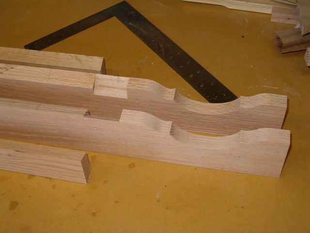

- Corners ready to assemble.jpg (128.25 KiB) Viewed 8881 times
- HPIM1150.jpg (118.99 KiB) Viewed 8881 times
- HPIM1084.jpg (133.4 KiB) Viewed 8870 times
