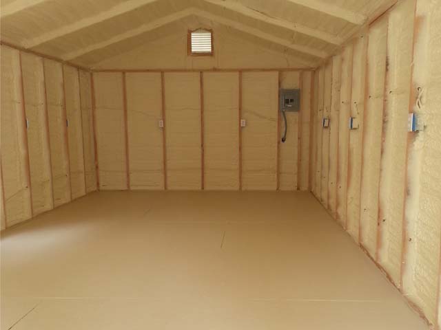

I know the floor looks yellow in this picture, but I assure you it is a sand color. The reflection from the spray foam makes it look kind of like a mustard color, but when I took this picture I still had no electricity. As you can tell by looking at the end of the building, they forgot to spray foam over the vents that are on each end of the building. Since this was a repo, I had to leave the vents, if I was purchasing new I would have had it made without them. Anyway they are supposed to come out to the house an spray over the vents to keep the AC in, but for now I will cover them with cardboard.
[ATTACH]22641[/ATTACH]
I purchased some thin wall paneling to cover the walls, will paint it a semi-glass white and then place my cleats on the walls to hold tools etc. I have been constructing new benches to go along the walls for my equipment when time was available. I am off for 5 days starting today and hope to get a lot of work done, however I will be working solo for the first three.

If you haven't already before you panel the walls put metal wire protectors over the studs where the electric wire is passing through. 10 years down the road when you forget where the wires run you don't want to be hammering a nail in and hit the wire.
Also the down around normal receptacle height I see the studs are drilled. You might consider running some pvc pipe for future air use. I would stub out a couple outlets now before the paneling went up.
Frankly knowing what I know now I would mark on the wall the top and bottom of hanging cabinets and panel from them up and from the marks down and I would put ply in between. That way when you do put up cabinets you don't have to worry about finding studs you can nail any where and know you have support.
Another idea you would never regret is starting at bench top height use a full sheet of 4x8 ply on its side around the room going up the 4 ft above the bench level. That way in the future if you want to hang or attach anything on the wall you can anywhere you want it. Use the paneling to finish the rest.
Believe me you will want to change your shop around from time to time as your interest/needs change. Having the flexibility to put things where you want on a wall instead of just were the studs are is great.

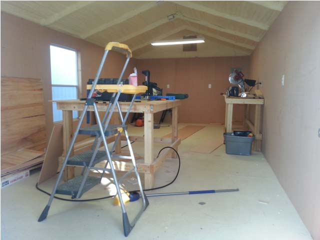

Because. I was somewhat side tracked by my father-in-law yesterday, I called up my 18 year old grandson and asked if he wanted to make a $100. He had called last week looking for some odd jobs to do on the farm, to make money, but at the time I did not have anything that needed doing. He jumped at the offer, so we finished the inside walls and got to do a little bonding. I did all the measuring and most of the cutting he did most of the nailing and screwing of the panels with assist as necessary.
Sometimes his technique was not up to my standards, but part of being a grandfather is to let those small things roll, and I gave him some advice and direction on how to improve his technique. Once we were done, I wisked him back to his dormitory room at the college. In some places, the finished product may not be as good as I like, but the time we spent together was priceless and enjoyed by both of us.

Next step this morning is clean up, put up the rest of the lights and paint the walls....
