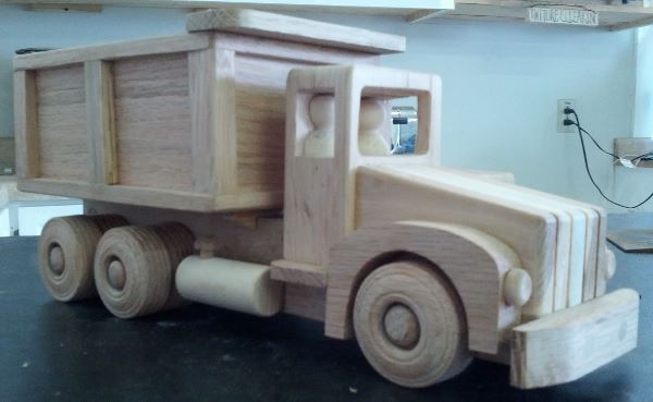

Toy Truck Wheels
Bill,
I make my own wheels similar to the ones from Hobby Lobby. I did six dump trucks this summer that took 60 wheels. They only seem to have one package on hand at a time at our local store. I cut 2 1/4" squares then countersunk a 3/4" by 1/4" deep hole in the center with a forstner bit. Drill a 3/8" hole all the way through. Use a bandsaw circle jig with a dowel for center to cut 2 1/8" rounds. Cut the head off a 5/16" bolt and put the wheel between two nuts on the threaded portion of the bolt. Put the former head end in a drill chuck and turn with lathe tools. The basic truck is from a magazine but I redesigned the dump box with mitered corners and biscuits to hold the sides to the bed. I use a dado blade to make the side panels.
[ATTACH]22757[/ATTACH]
Here's another interesting design for wheels:
[ATTACH]22758[/ATTACH]
