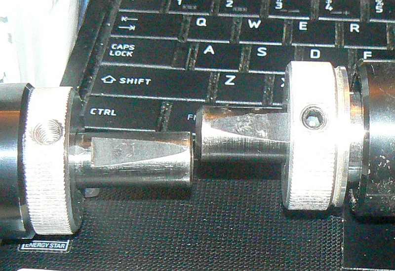

There are two versions on the quill collar that I am aware of. The original Mark 5/Mark V single bearing quill version and the double bearing quill version. If there are others, please add them to this thread.
The single bearing version is 'almost' 3/4" long. The two bearing version is just over 7/8" long. Only the total hub length varies.
FWIW, the two bearing quill end play is not controlled by the collar. The single bearing quill is. *
In all three pix, the shorter collar is always to the LEFT.
First the length difference pix.
[ATTACH]23026[/ATTACH]
Next the collars mounted to the correct quill. Notice the undercut portion of the collar is the same on either quill. Single bearing quill left, two bearing quill right. Both collars bottom out against the bearing inner race, but only the single bearing end play is controlled by the collar. *
[ATTACH]23027[/ATTACH]
Finally the collars mounted on the wrong quill two bearing quill left, single dearing quill right. Notice the short collar bottoms out on the quill(left) while the longer collar bottoms out on the bearing and does not go into the quill 'normally'.
[ATTACH]23028[/ATTACH]
* I have encountered 'later' single bearing quills with a second retaining ring groove(**) that may help control end play. The collar 'control' becomes relevant only if the bearing inner race slides easily on the quill shaft. My 'samples' may be 'non-typical'(non EOM!). (Clarification needed!!!)
** All quills I have encountered do have a retaining ring securing the bearing in the quill. The collar controls end play only if the shaft easily slides in the inner race. (Clarification done!)
Quill Collars
Quill Collars
- quill collars length.jpg (462.01 KiB) Viewed 1428 times
- quill collars correct.jpg (449.3 KiB) Viewed 1424 times
- quill collars incorrect.jpg (436.45 KiB) Viewed 1432 times
I am a bit curious about the quill side of the saw arbor in the pix. I looked at all of my saw arbors and I did not see any or do I ever recall seeing any saw arbor that has a tapered collar at the saw blade. I may be wrong, but do you really have a SS arbor or could be an off brand knock off? Is it a universal arbor? (not safe to use on a saw blade) JPG what do you think?
Bill V
Bill V
I think you have never(previously) seen a 5/8" arbor with a 'taper' on the quill side.wa2crk wrote:I am a bit curious about the quill side of the saw arbor in the pix. I looked at all of my saw arbors and I did not see any or do I ever recall seeing any saw arbor that has a tapered collar at the saw blade. I may be wrong, but do you really have a SS arbor or could be an off brand knock off? Is it a universal arbor? (not safe to use on a saw blade) JPG what do you think?
Bill V
skou wrote:Bill, those "ain't" arbors.
That is the quill, with a quill collar on it. The collar is a piece of the quill, not something you'd normally remove, in normal use.
Although, the arbor on the SawSmith has a taper, AND threads.
(Guys, on the SawSmith, is that a quill or arbor?)![]()
steve
A quill moves 'in/out'(sideways does not count]http://www.shopsmith.net/forums/showpos ... ostcount=1[/url]
There are 'other' meanings for quill and arbor that are totally irrelevant.
I have corrected an oversight in the top post of this thread.
