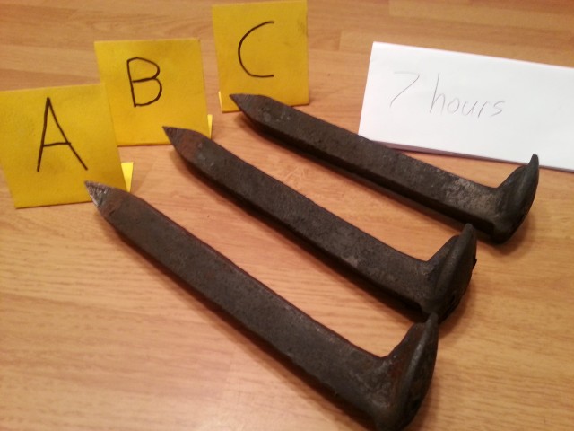

After 7 hours in the electrolysis, there is visually not much difference between the three test pieces. The piece in the tank with the lowest current has some rust under the head of the spike that the other two no longer have. Otherwise, they all seem to be covered with the same amount of black oxide.
The tanks tell another tale, though. Tank A (with the lowest current) has mildly murky water, some very minute sludge accumulation around the sliver of anode submerged in the solution, and that's about it. Tank C (with the highest current) has much darker water and a good bit of rust flakes and other "crud" floating around and sitting at the bottom of the tank.

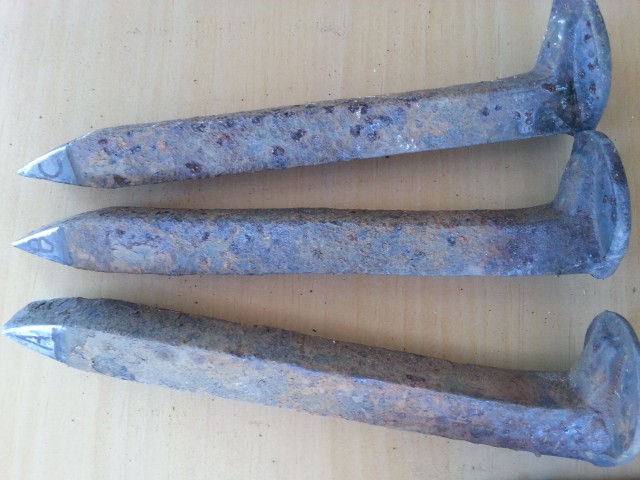

These are the spikes as they started out. I filed down a spot on the end to clamp the negative wire to and so we could label them.
[ATTACH]23225[/ATTACH]

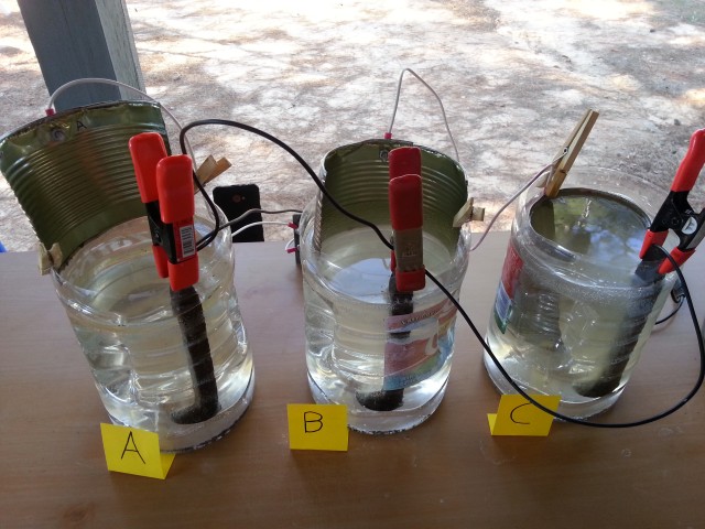

And this is our three tanks set up with the anodes adjusted to provide a range of currents. THANK YOU so much JPG40504 for the diagram you made. That opened my eyes more than anything else and provided the basis of our setup.
[ATTACH]23229[/ATTACH]

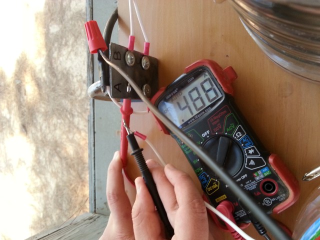

What you can't quite see behind tank "B" is the connection block I made for connecting our positive wires to. This allowed us to easily disconnect one of them so we could check and adjust the current as seen here.
[ATTACH]23230[/ATTACH]

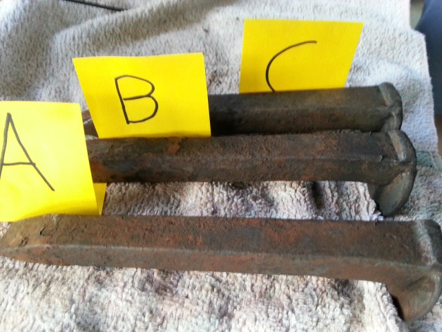

These are the spikes after 3 hours. It's amazing that the camera sometimes sees things in a different way. In the first picture above, they looked a lot more rusted to our eyes than they did to the camera. And we couldn't see those red/orange spots of rust on the "A" spike at the time of the picture below, but the camera could!
[ATTACH]23226[/ATTACH]
These are the spikes after 7 hours.
[ATTACH]23228[/ATTACH]
