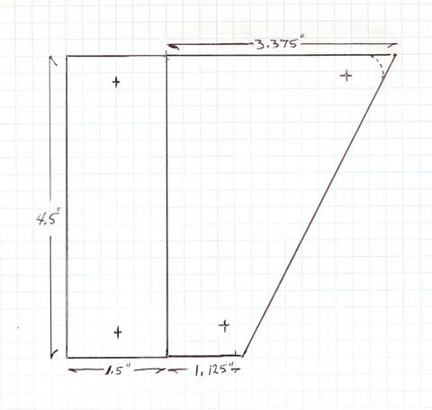

I made an "L" metal bracket shown below to mount the Shopsmith Mark V retractable casters on an 10ER. The 2" casters have a 90 pds limit per caster. I have 3" stem casters available that have a 180 pd limit per caster that fits in the caster assembly.
[ATTACH]22935[/ATTACH]
Retractable Caster Bracket.jpg (18.89 KiB) Viewed 2778 times

rlkeeney wrote:I've been considering this option. I bought the Shopsmith casters with the intent of modifying them to fit a Shopsmith power station.
Not sure what you intended to 'modify', but you will need 9/16" spacers and longer screws.
I reversed the cam shafts on mine so the foot pedals are accessed from the outside.
