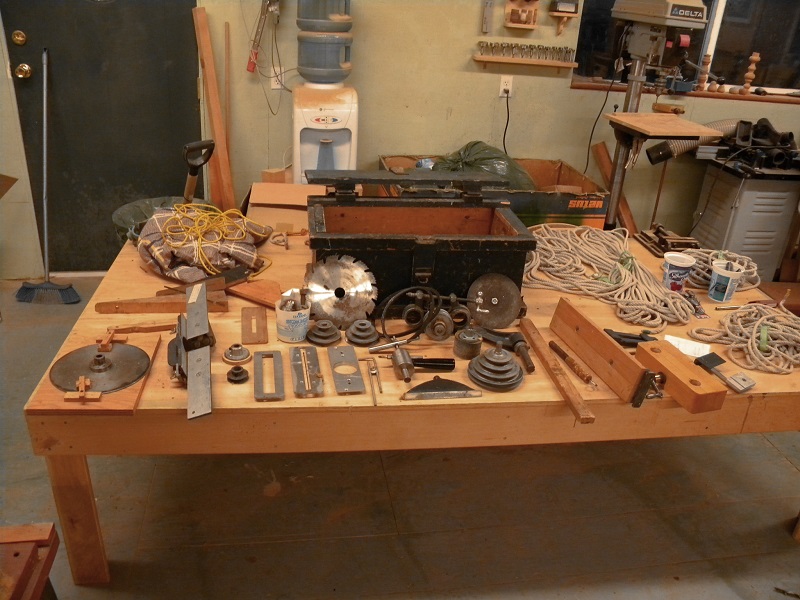

The last photo in post #8 reminded me a lot of the "Treasure Box" that came with my 1950 10ER. While not exactly the same the size and construction, they are very similar. Does anyone know if Shopsmith had a plan for these? ................. Likely just a coincidence.
[ATTACH]23067[/ATTACH]
Very Good score BTW.
