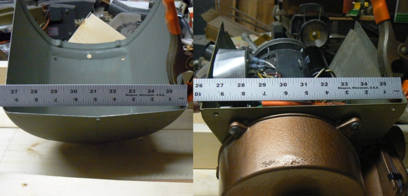

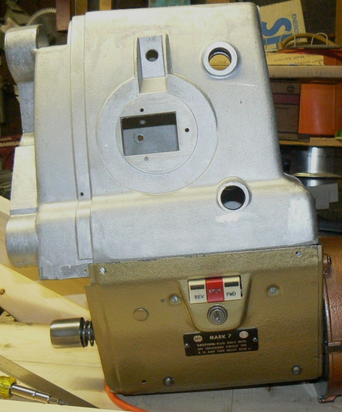

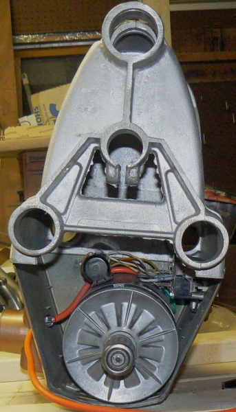

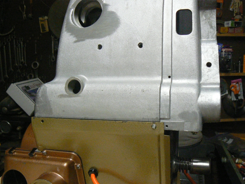

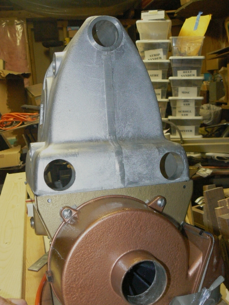

Info on putting Mark VII motor into Mark V?
MVII motor & pan on M5 headstock casting("A")
- MVII.M5 width.jpg (237.49 KiB) Viewed 624 times
- MVII.M5 left.jpg (415.91 KiB) Viewed 622 times
- MVII.M5 rear.jpg (213.04 KiB) Viewed 619 times
- MVII.M5 right.jpg (266.26 KiB) Viewed 625 times
- MVII.M5 front.jpg (253.71 KiB) Viewed 627 times
A nice looking installation. I never considered this option as the motor switches were always bad on the Mark VIIs I disassemblied. I was not sure what to do with the motor pan holes for the vacuum since I sawed the vacuum shafts off a couple of them and the motor pan was slightly wider. Switching the motor to the Mark V motor pan was the path I took. I still have 4 Mark VII motors set aside for this conversion once I got all my current jobs and projects done. Next years projects. After doing a few Mark VII motor conversions, I learned how to reverse the GE and AO Smith 1 1/8 HP motors so these Mark VII motors were stored as it took more time to do their conversion for the Mark V.
I set them together to take pix for damagi to peruse. The MVII motor will go into my MVII when restoration is complete.
I think it could be made to work, but the belt cover?????
