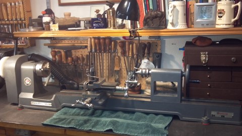

Geo, here is a picture of my 1973 Rockwell Delta lathe configured to do metal work. I have it geared to go slow and use it to turn plastics, brass, and soft metals. It doesn't have a thread cutting feed screw, so I hand cut all my threads.
[ATTACH]23428[/ATTACH]
I purchased from Delta the compound slide rest, which in my opinion is essential in doing metal work. I have a Delta three jaw and four jaw check and numerous metal cutting bits in HSS and Carbide to include hollow cutting bits. Grizzly is a good source for accessories.
