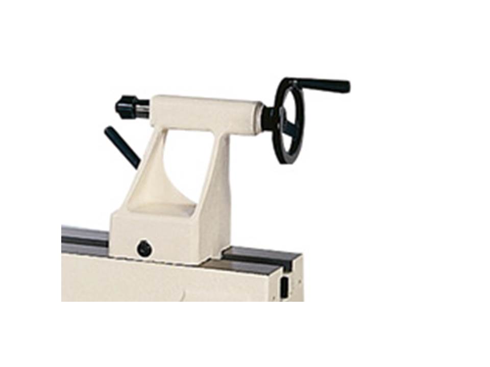

Live Centers with Adjustment Wheel
Post by c2h6o »
For many non-SS lathes, the live center is a device that with a turn wheel that allows for very good seating of the wood object to be turned. Does anyone know if there is such a thing made for a ShopSmith.
c2h6o wrote:For many non-SS lathes, the live center is a device that with a turn wheel that allows for very good seating of the wood object to be turned. Does anyone know if there is such a thing made for a ShopSmith.
The SS quill provides the same function at the drive end.
