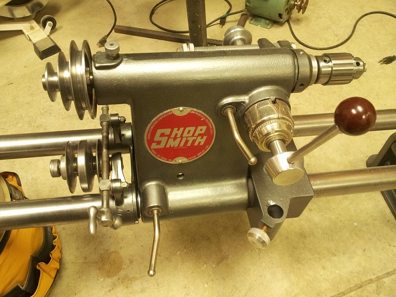

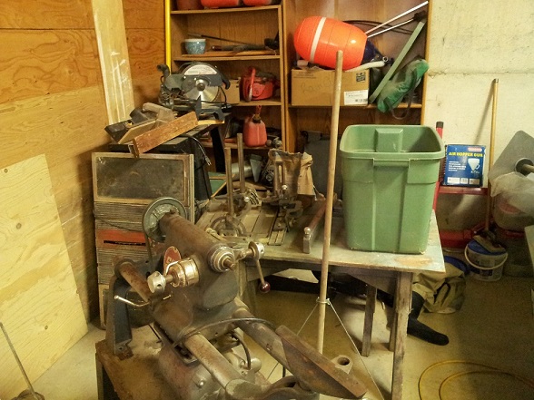

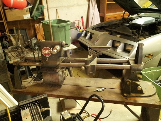

Finally have time to get at restoring my shopsmith 10er
As always taken down to bare metal as no primer was used in painting these.
Used metal prep or evaporust for bare or rusted metal to neutralize any rust or metal,
cold zinc compound so rust can not bleed thru.
Etching primer, then on to painting.
Really enjoying restoring this Shopsmith for the basic design and reliability

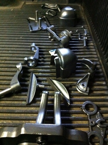

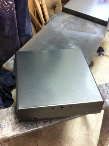

- IMG_20131230_122525.jpg99-9.jpg (124.9 KiB) Viewed 2042 times
- IMG_20131230_122531.jpg (120.77 KiB) Viewed 2023 times
- IMG_20131230_122537.jpg (127.97 KiB) Viewed 2014 times
- IMG_20131230_161619.jpg (144.24 KiB) Viewed 2016 times
- IMG_20131230_232919.jpg (136.74 KiB) Viewed 2041 times
Moving along
A few more parts painted etc. Hope on putting it together in the next 2 weeks!!
Or so?

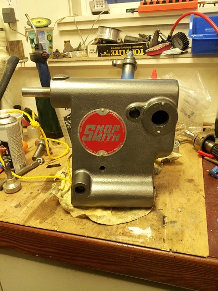

I used a Plasti Kote color #1029
GM Storm grey PRL M BC
It covers easily
Or so?
It covers easily

That is gonna be gorgeous!!!

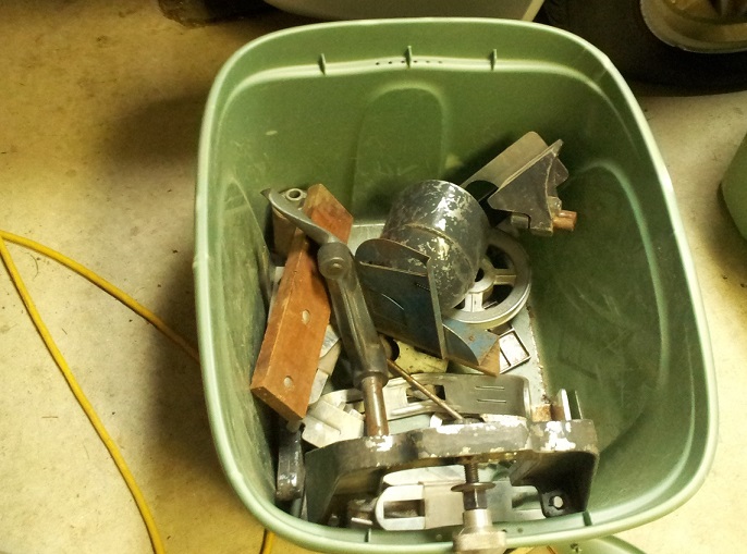

2 tool rests, 2 belt covers, 2 blade guards????
Shopsmith 10 er
I have double because, I had one given to me incomplete.
And bought another with the other parts to finish it.

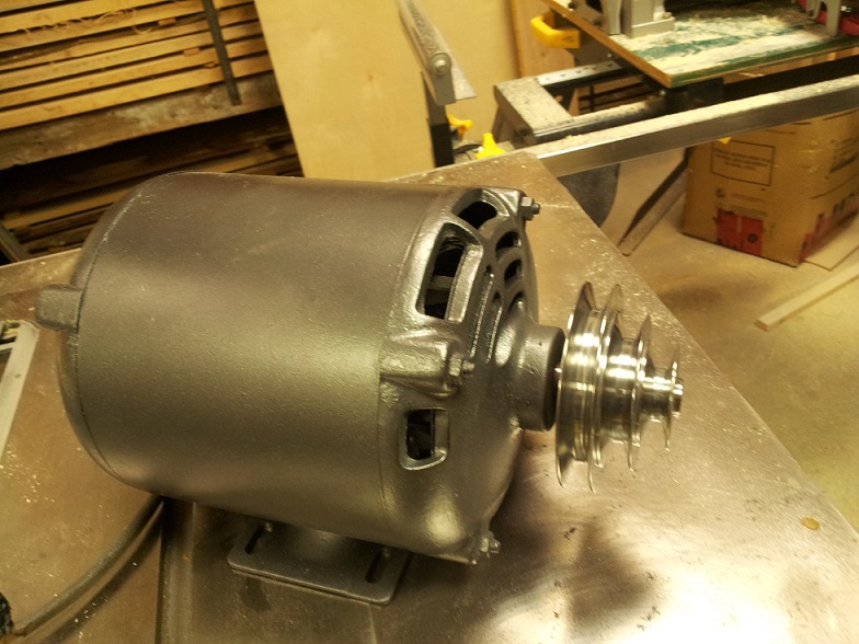

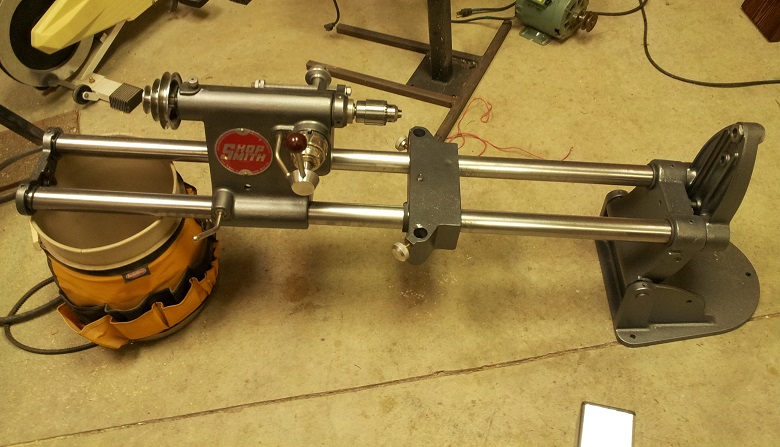

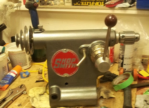

Moving a little slower that thought
Had to build a few cabinets and granite tops
back at the shopsmith 10 ER today
Motor ready to go also
- IMG_20140103_231654.jpg99.jpg (139.99 KiB) Viewed 1999 times
- IMG_20140103_231920.jpg99.jpg (175.78 KiB) Viewed 1989 times
- IMG_20140104_205349.jpg99.jpg (192.61 KiB) Viewed 1998 times
One more picture that did not load

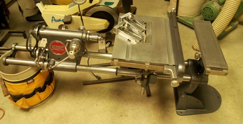

Having a good time restoring this one the table saw top and extension had not been used
- IMG_20140111_212709.jpg99.jpg (119.88 KiB) Viewed 2017 times
Veeeerrrry Nice!
Now put the carriage on reversed from the way it is in de pix.
The lock handle faces the same side as the headstock lock handle!;)
