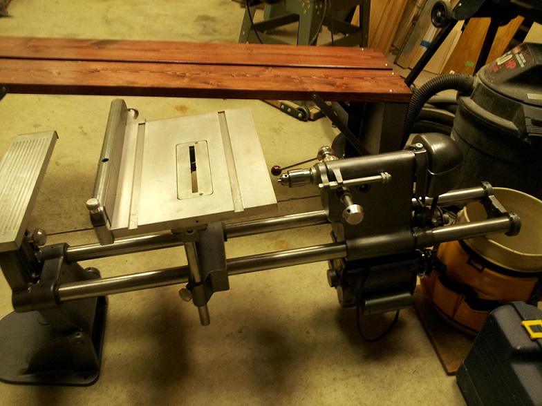

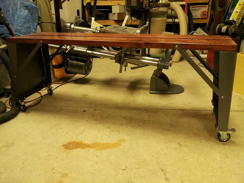

Getting Close to finished
Post by greg1m53 »
just need my friend to help lift it up and bolt it down, and a few odds and ends
Ahem!:rolleyes:
The tailstock is reversed.
The groove for the table mount and knob face the outside. That means the table is also reversed on the mount. . . . And the 2MT socket.
Still very nice. Slick wheels! Good looking 2x6s.
How come ya need a helper?????:D
I do hope you have a tube rest.;)

Checked the table, that is the side the holes are for mounting the metal bar slot for the guide, no holes if I reverse it?

Greg, unbolt the extension table from the cast iron mounting leg. Bolt it back on, backwards, but don't tighten down the bolts.
Now, remove the tailstock, and install it so the groove that the mounting leg mounts on, is on the far right (outside) of the machine. Slide the main table and carriage, down so they line up with the ext table. Make sure the 2 tables line up, and tighten those bolts.
steve
Yeah I shoulda told him the table was backwards on the mounting bracket!:o

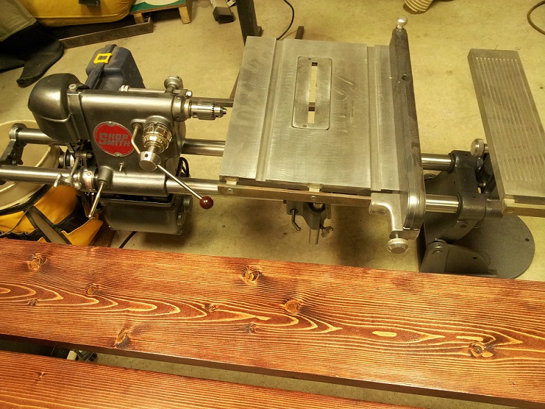

Like This??
Post by greg1m53 »
Had some time today.
greg1m53 wrote:Had some time today.
YES!:):):):)
Did you also reverse the MT2 tailstock 'socket'?
I see yer 'helper' 'performed'.;)
Yer gettin' there splendidly.:cool:
