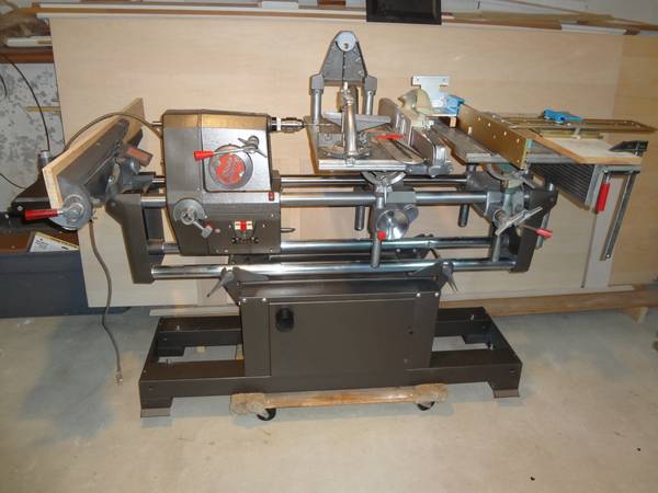

I've seen a few for sale.What's the deal with them?Are they a poor overall design?
- 00F0F_lG57RzuIoxp_600x450.jpg (32.98 KiB) Viewed 3463 times
The design isn't poor per-say. It's the lack of parts availability.

A few not so good things, and many good things.
First the really bad:
The plastic(nylon) speed control cam melts if the control sheave hub bearing gets hot.
The plastic(nylon) gear rack on the backside of the front way tube can dry out and break, or get worn down.
The power switch tends to wear out(a ge stove design).
If all these things are still intact(or a proper work around) they can be a good option.
Now the sorta bad:
A lot of unique parts(different from Mark 5/V/7) that are not available from SS.
And finally the good:
Many design features of the later models originated with the Mark VII.
Not all are earth shakers, but, have been incorporated into the 505-520 models.
The carriage clamp is a flip handle.
The table height is crank operated.
The main worktable is larger than the 5/V, but smaller than the 505-510.
However the extension table is attachable to the main table so as to increase it's width.
The table/headstock spacing is tightly controlled and can also connect the two so as to move together.
The backside of the smaller sanding disk is 'conical'. The smaller size allows using the disk 'in the table insert'.
The motor is 'reversable'.
And then there is the double tilt thing(under table rout/shaping).

I agree and it has an extra table/carriage to boot!paulsgreenbarn wrote:Ok thanks,the one pictured sure looks in good condition.
I need to mention that the gear rack can be worked around. It then becomes like a Mark 5/V/7(shove to move it!:D).
I think it is missing the casters though.
Gonna go back and take a closer look!
- Posts: 35430
It is missing the 'vacuum' blower housing etc.
It didn't work very well anyway. 3450 rpm is not very fast for a vac blower.
However the design was near the same as the present DC3300.
Now that fence is a definite ++++++++++++++++++++++.(the gold colored one!:D)

- Posts: 35430
That looks like original paint. Good condition indeed(assuming the speed control is in as good condition as the rest).
