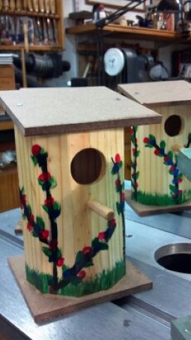

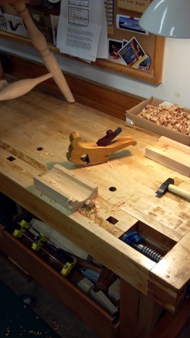

I made bird houses last winter with some scrap wood I had left over from backyard fencing project. I had all these ceder 2x4 end cuts. I hollowed out the pieces of differing lengths using a carriage plane as pictured below. However, you could do the same thing with a cove cut on the table saw.
[ATTACH]24146[/ATTACH]
Once hollowed, waterproof glue the two sides together with a spacer in the center to give the inside hollow more room. Drill your hole. I used a 1-1/4" fostner bit. I used a 1/4" dowel as a support outside the hole. I then cut the top off at about 10 degrees so the roof will shed water and put on a bottom with left over ceder fence plank cuttings. A little sanding, paint to your desire if so inclined - I don't think the birds care, but I do - and you are good to go. They really used these this past Spring and Summer.

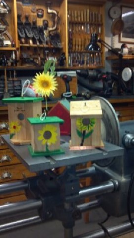

I also experimented with some scrap pine I had, making eight sided bird houses. Eight sides required an edge miter of 22.5 degrees. Glue using rubber bands. The birds liked these too.
[ATTACH]24148[/ATTACH]
