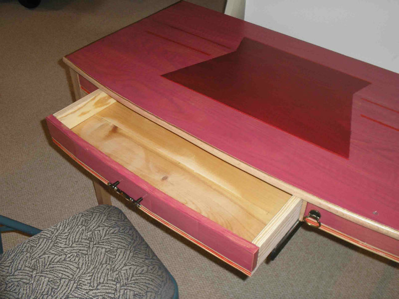

Bowfront Drawer I made with Tilt-Table SS tablesaw
This was the first major project I did with my Mark V. I remember drawing out this bowfront and cross-cutting a number of pieces that had the table at a tilt of no more than 3 or 4 degrees.... my calculations have been lost in the sands of time. I still use this table every day:
[ATTACH]24157[/ATTACH]
