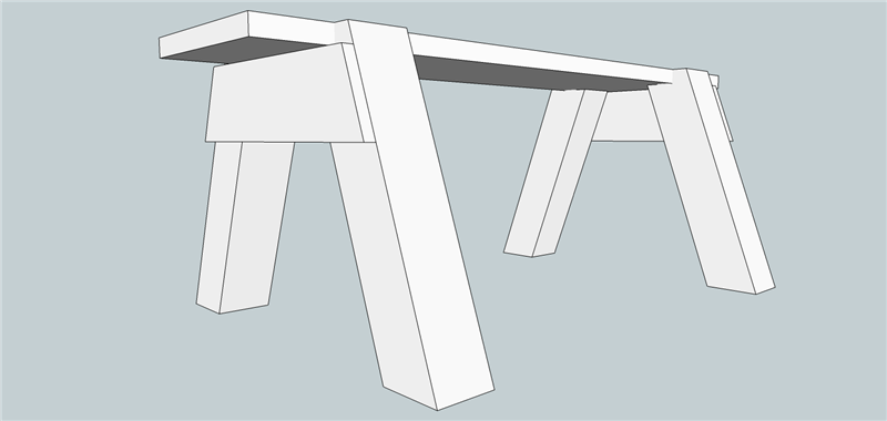

Given that I cannot buy shorter legs and that I do not have the skill or the equipment to cut a section out of the legs (to make them shorter), I have been preparing to mount mine on a saw horse (like the 10E or 10ER).
Sorta like this.
[ATTACH]24183[/ATTACH]
What has been slowing me down? Concern about the resulting height for the band saw, jointer and any other SPT that I might want to mount there. My internal counter argument is that the bench could always beed used for a bench if it does not workout.
- Saw Horse (Custom).png (52.7 KiB) Viewed 5997 times
