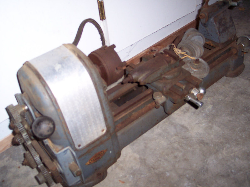

As a diversion during my last machinest-chest project, I got a derelict, very small metal-lathe.... free from my brother in-law :D :
[ATTACH]24240[/ATTACH]
I have gradually been cleaning it up and I just lately installed a new, straight spindle. I'm aware that the Craftsman/AA/Dunlap 109 isn't the finest lathe in the world, but I think I'll like it for occasional small-time projects.
One thing that is missing is a Motor. I've spied a 1/3-hp unit I could use in a local antique mall, but even there I've read that a typical 1750-rpm motor with the 3-step pulleys runs the 109 lathe a bit on the too-fast side. SO.... I'm wondering if I shouldn't just drive a belt from my PowerPro headstock to the 109-lathe on a roll-up table. This would let me go as slow as 250rpm straight-out, and 5 times slower if I engage the back-gear on the lathe.
Questions I have for you guys are:
(1.) Is a pulley on the Powerpro quill or back-side spindle-end OK? I'm thinking of using a link-belt over to the metal-lathe. Any good sources for a pulley? And a belt?
(2.) Or would approach (1.) cause too much side-load on the Powerpro/Quill bearings? Would I be better off to "hang a pulley" between the Quill and the Tailstock-center of my Shopsmith? Any idea what sort of parts/bearings to use for that?
Thanks in advance.... and stand by for updated pictures in the weeks coming up!

I have been attracted to your ideas, basically making the metal-lathe's spindle an extension of the PowerPro's spindle....
The main compatibility challenge there, is that the "109" metal-lathe's spindle will have a gear on it, the very upper gear shown in that picture. That gear drives the rest of the gears if one is using "threading" or "power-feed" features. That gear occupies the whole length of the exposed spindle. So an 'adapter to the Shopsmith' would have to duplicate those gear-teeth.
On the other hand, if I run a belt to the pulley inside the 109-lathe's headstock, I can preserve all the 109's features: power-feed, threading, and back-gear 5:1 reduction.
Hoping to find the best of all worlds....
Chris
