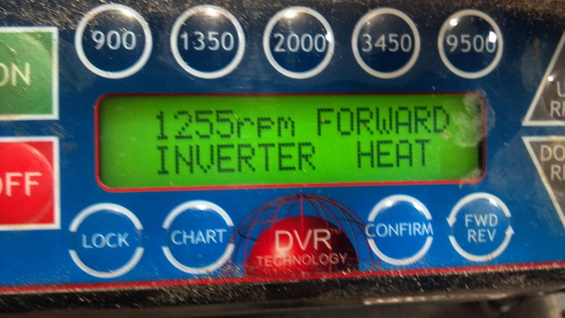

Overheating a PP
Here is what showed up on my display after several hours of turning and sanding 5 bowls one Saturday last Summer. It was 78 in my A/C ed garage/shop. The PP never stopped but I let it cool down for about an hour and it never has displayed that message again.

Since my PP came with my M7 I did not do a rebuild. Is there a fan with the the PP? If not, I wonder why. Computers have cooling fans to reduce the heat. If there is one, should it be a larger capacity? If there is not a fan, is it realistic to modify the case to accept a computer cooling fan?
Just wondering.

I would suspect the reason for no fan is SS didn't want to suck dust into the internal workings.
