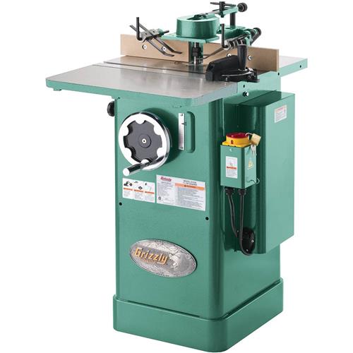

I bought one of these used for less than $200.beeg wrote:A standalone shaper will run ya more than a THOUSAND DOLLARS.How about a good router?
[ATTACH]24734[/ATTACH]
The top was rusty but that cleaned up nicely It came wit a cabinet door cutter set.
- Grizzly_G1035_Shaper.jpg (24.24 KiB) Viewed 1876 times
I have the G0510Z 3/4 HP Shaper sold by Grizzly. I have owed one for 25 years. You can find it here:
http://www.grizzly.com/products/3-4-HP-Shaper/G0510Z
It is on sale right now for $395.00 plus shipping - so you don't have to spend a grand to get a good shaper, or less money and get someone's used machine.
I have used this shaper to cut hundreds of feet of oak molding over the years. It will take shaper cutters and 1/2" shank router bits. I have never had a problem with mine. A great machine, well worth the money.
